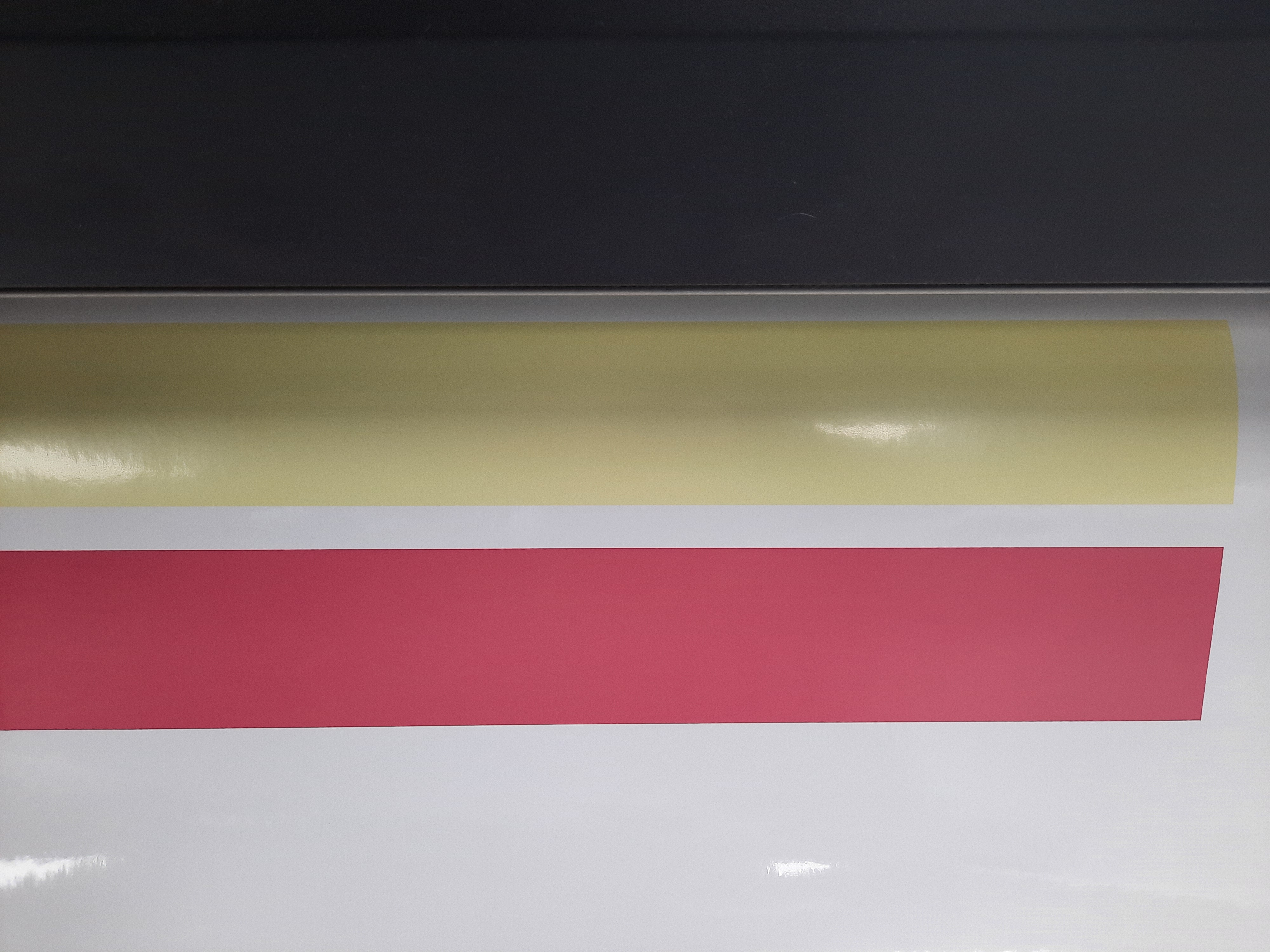

Reds are now printing closer to magenta, and Yellow block is muted and light.

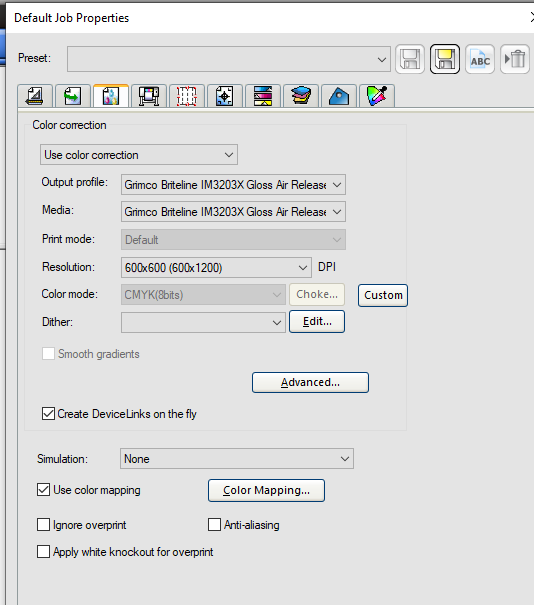

1. Could it be the Flexi Update causing problems with the colors? (I am attaching the setup)
2. Could it just be the ink? Is there any way to check that before popping for new ink?
Any thoughts or suggestions would be appreciated.

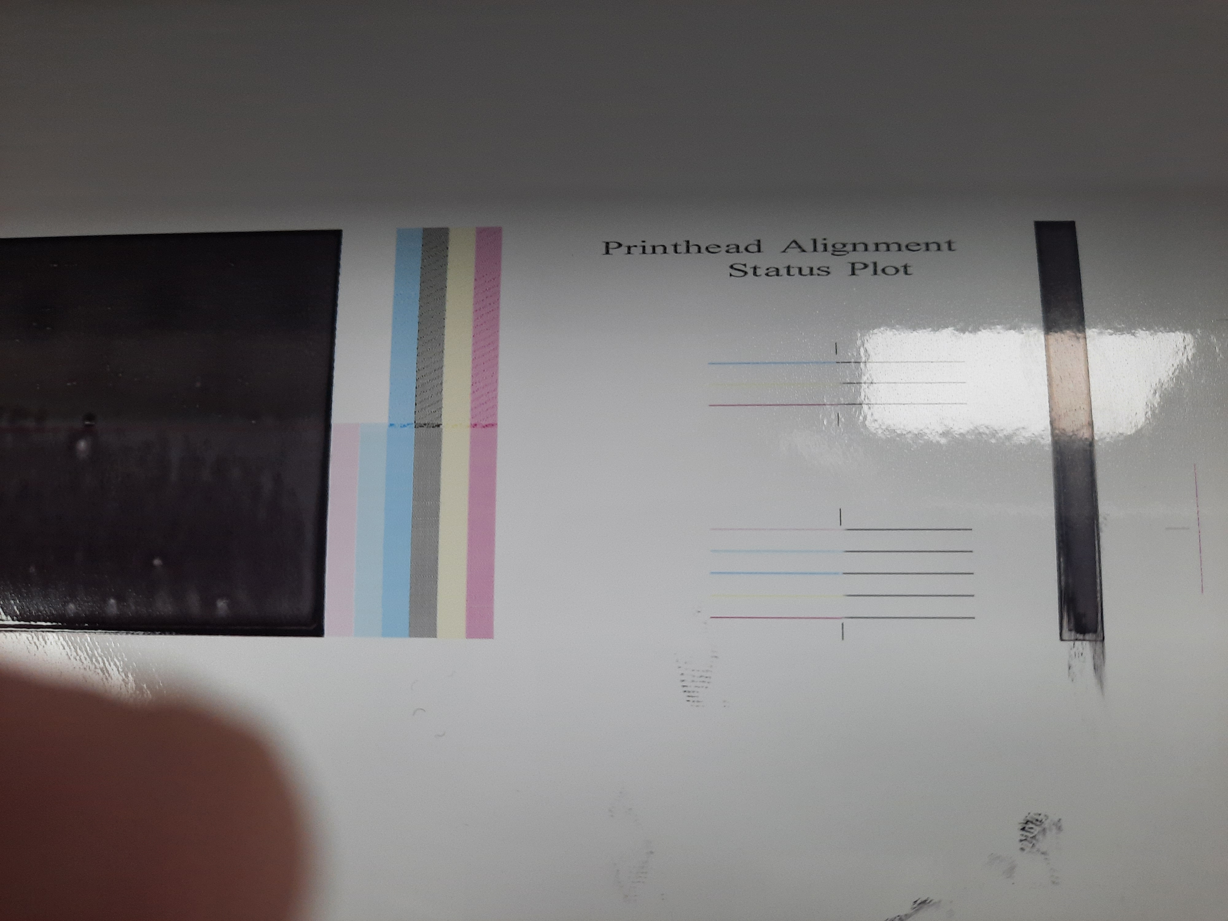

How is the nozzle test print?
Take out the cartidges, give them a good shake and them you must print fair amount to refresh the ink. (30ml per ink).

Silly question but where do I find the nozzle check in the menu? I am asking it to do all test plots at the minute. Never had any issues yo to this point. Prints seem fine but just these color shifts.
mameighan

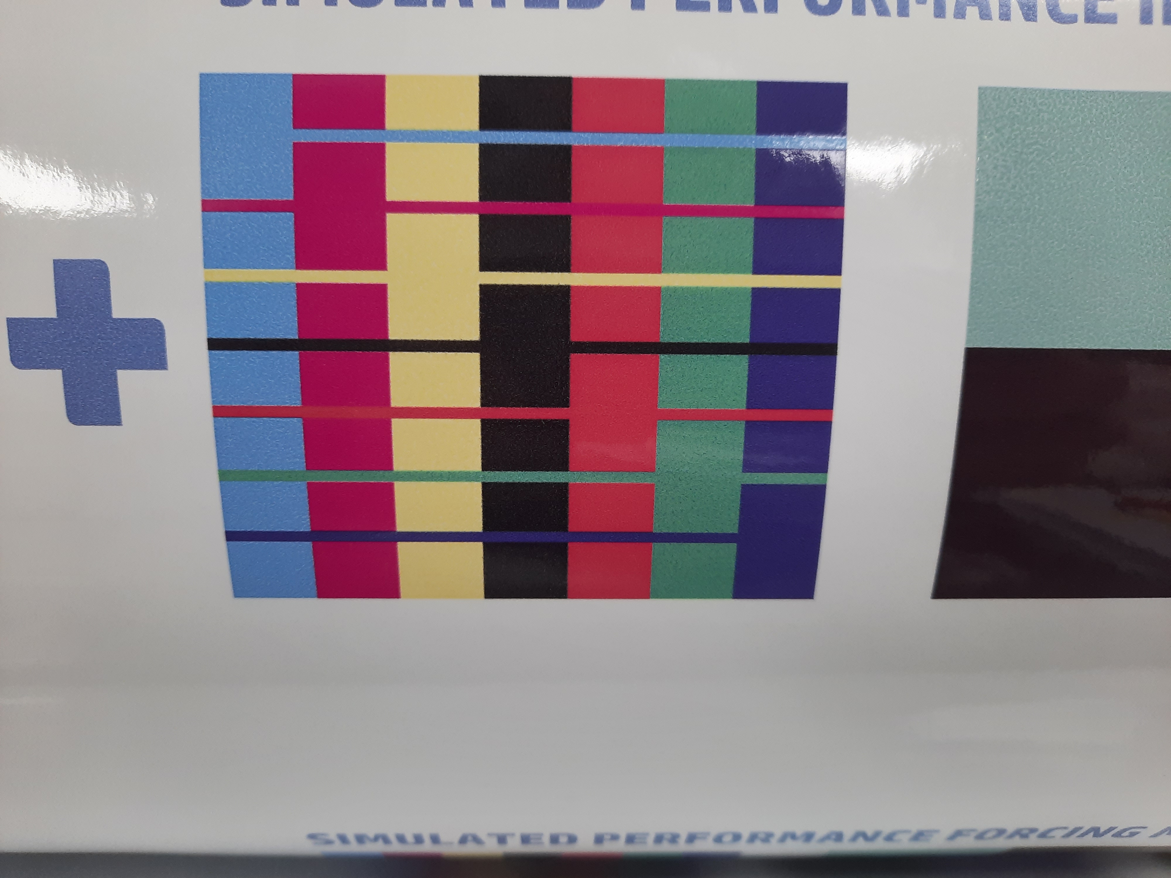

Ok I printed test plots - not quite sure what I am looking for but do these look normal is the alignment plot missing the light cyan and light magenta?
