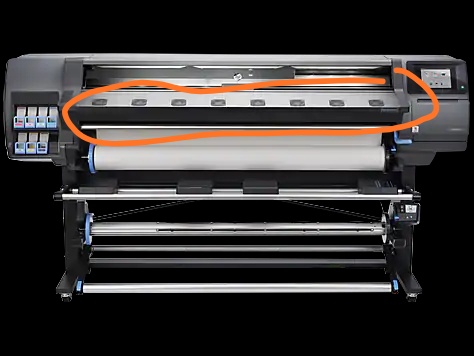

Hp 360 has 8 curing modules? As much as the fans showing?
jimmmi
Those are air curtain fans to prevent condensation and to protect operator in front of the printer. 2 fans for 1 heater inside the curing module.
So despite these 8 fans there are 8 more fans inside the curing unit?
