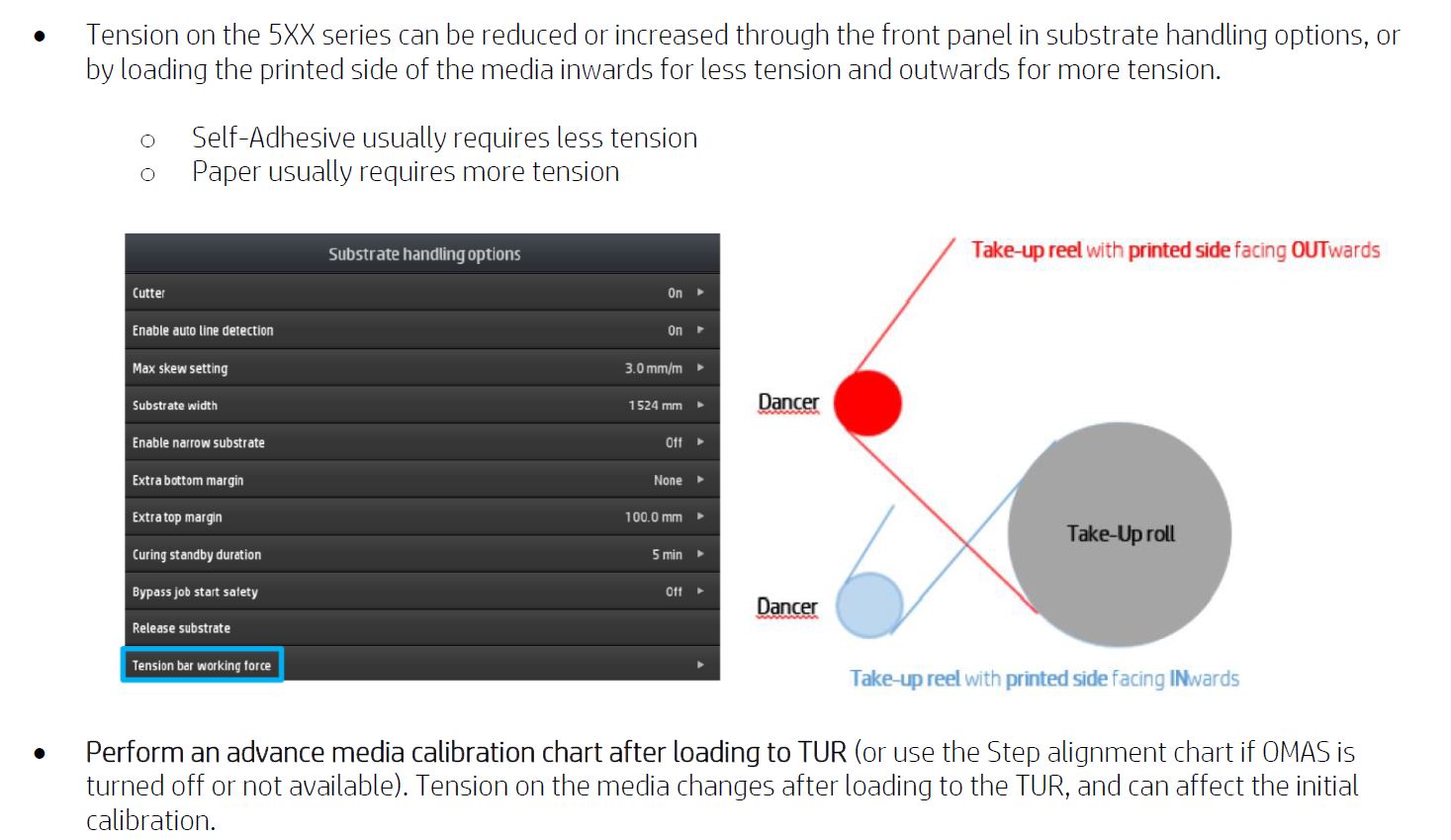

(Latex 560/570) Which direction do you spool your takeup?
flyplainsdrifta
i go both ways. depends on the material. anything more prone to curling post print i will go face out. anything else goes backer out.
See image attached for a description of the TUR options on the Latex 500 Series

Graphic side in for anything I'm mounting and graphic side out for anything I'm putting on the CNC. Makes unrolling easier for what is happening to it next. Of course, caution is taken depending on material but I'm almost always running Oracal 3640 or Jarhead.
