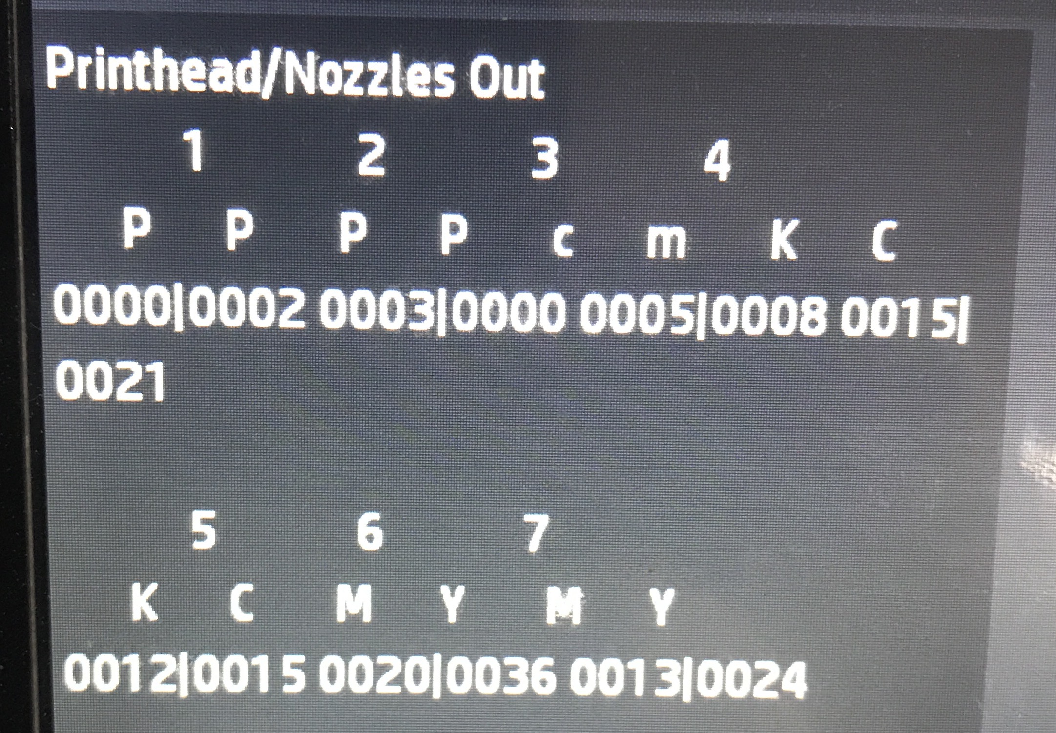

ericm
To find out if the head is bad do a forced drop out test anything over 86 to 96 replace the head it's that simple!!!!!!!!

balstestrat
Problem Solver
hmmm did not know about that force drop detection... I had 500-700 per color. Guess I need some new heads!
You have that much you should be able to already see it from the crap quality of prints. Like months ago.
Are you sure you there's not another explanation?
AGCharlotte
I had noticed a little banding on occasion recently but not enough that I felt the quality was off. Was holding off buying new heads since we're supposed to be replacing it in the next few months. Just did a few test prints to check the heads and everything looks good. Not sure how that force drop detection was getting numbers so high if I'm not having issues.
