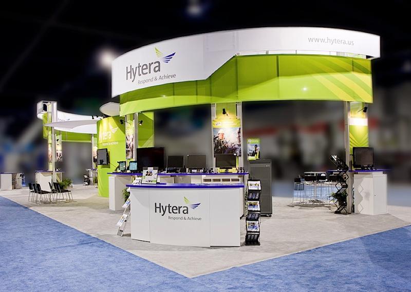

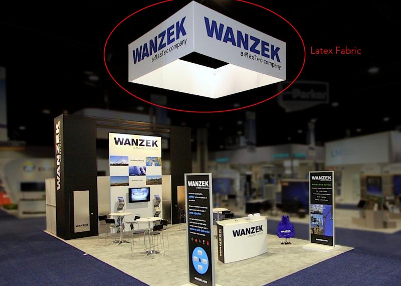

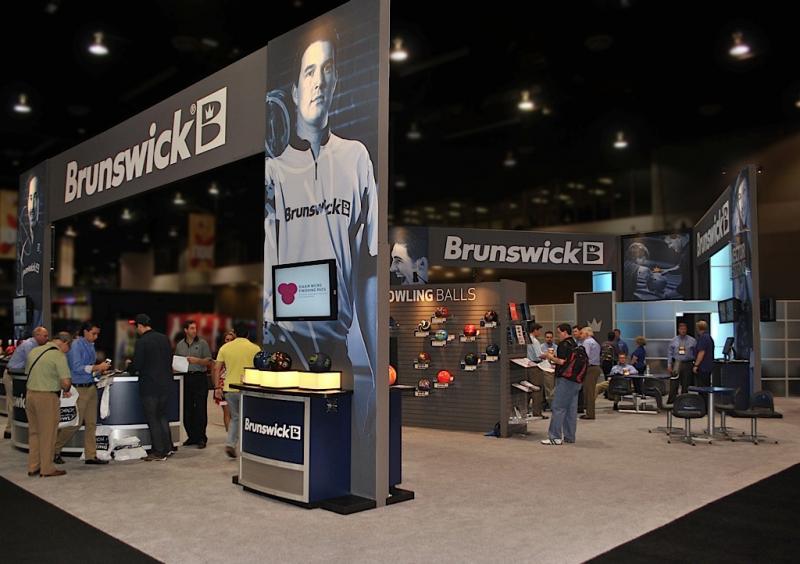

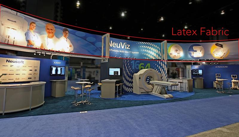

I can only speak for our uses but tension fabric on aluminum frames is one of our big markets. The latex printed textile is great for fabric structures at trade shows that are only going to see 1-3 shows and then get tossed. It's no where as durable as dye sub but it still works great for us. I'll have to throw some pictures up of some of the signs and displays we have done in the past year. I think almost every project I have worked on has some fabric incorporated into it.
sballinger
Ok here are 4 exhibits our shop did the graphics for. The Brunswick booth has lots of latex fabric, the upper panels and the images of the bowlers...all latex. Hytera's upper id system is also latex fabric. The stuff works great!
sballinger
The finishing ranges from velcro (like the Hytera job) to Silicone Edge material (like Brunswick) All cutting and finishing is done in house. We are a very small shop so I've learn to run our Juki lockstitch machine very well!
