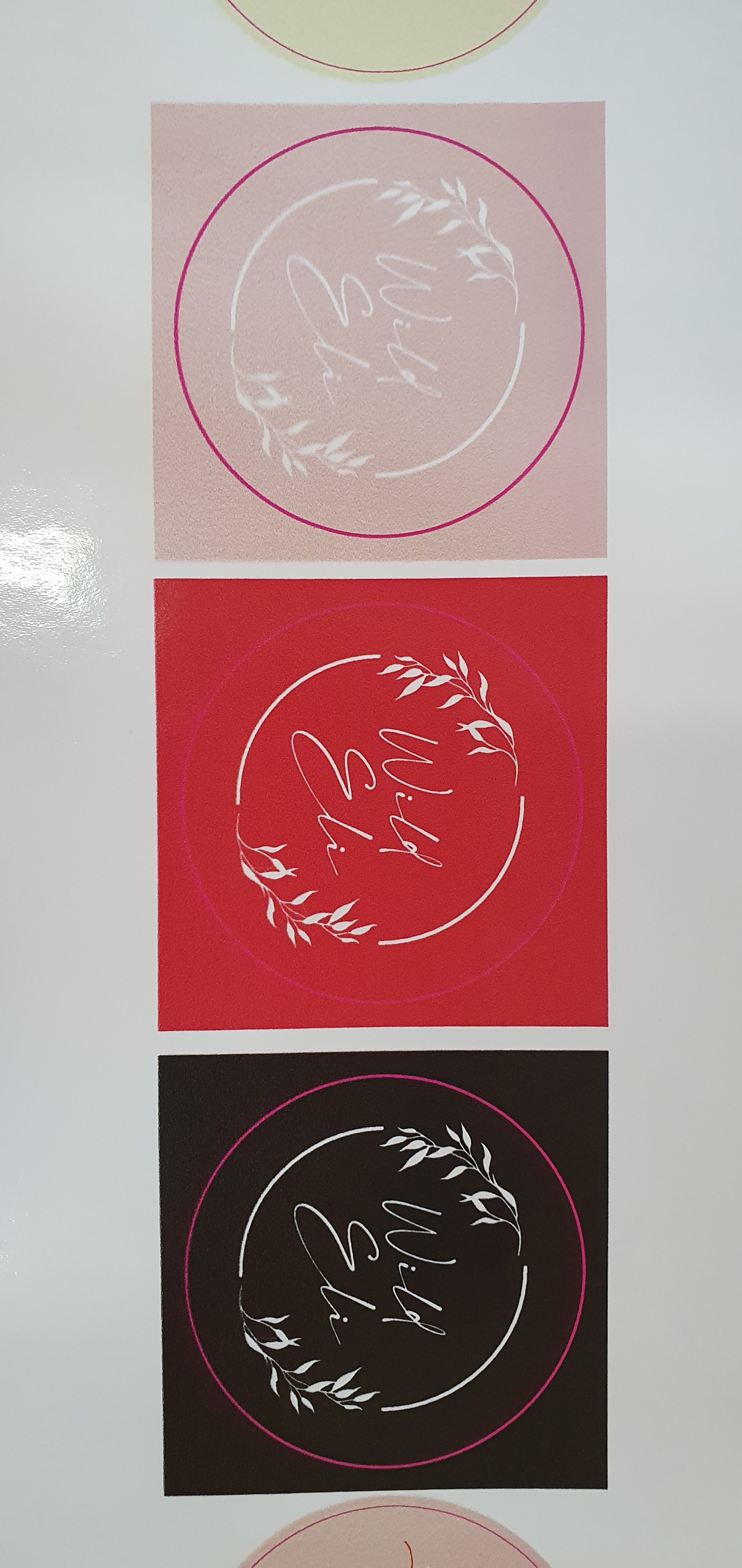

Hi im having the same problem as always. What it could be with pastel colors ? Tried all kind of vinyl this in picture is ecosolvent gloss vinyl.
kanini
Pastel colors are a bit difficult on the latex in my opinion, you need to go high pass, at least 16 or higher or so and use material suitable for latex. Do an image quality optimization before printing. Good luck!
