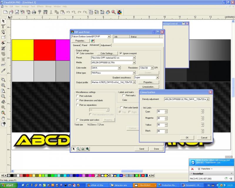

In 8.6 (8.1 should be the same) you can find it when you pull up the job manager from the production manager.
It is the 7th tab over from the left - "color adjustment"
In there you can pull all the channels down at one time or single channels by selecting each one.
10% off all channels is a good place to start.

Does this help?
