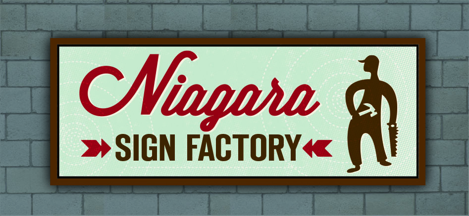

For a few bucks you can bust out of the square and give it a bit of dimension... we all hate cheap customers, why do it to yourself...
I had another idea because I'm bored...

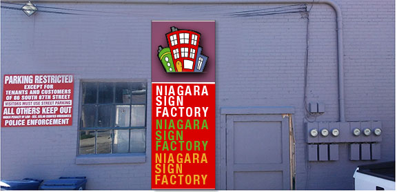

rick, i love your designs.
i printed the last one i posted, the red one and stuck it.
hope to have it up next week.
as far as why not next to the entrance, my building is a giant U shape, with the entrance in the middle. this part of the building faces the street. i have soooo many projects started i definitely don't need any more. i was cleaning the shop and just couldn't throw this sign out. i just wanted to throw up a quick sign before this thing was in my way for another year....
i will be making a version of the retro one for the other side of my building, i'll hand paint it on red brick about 20 feet across.....add it to the list

I hated the clipart but actually really like the busting out rendition.

I believe ddarlak correctly identified what may have been the main weakness in the original layout. Too much white space. But it was not that there was too much white space surrounding the block of copy. Rather, there was too much white space within the letters and between lines.
The line spacing in the lettering, from top to bottom, was virtually identical. This is sometimes called “vertical justification,” and it is usually not a good design technique. It adds a vaguely monotonous element that is visually weak. It's an anemic, too-much-whiteness look that lacks strength. Yet it is extremely common in sign work today. And I think the reason for that is that it is difficult for many to identify as being a weakness.
In addition to the vertical justification, the medium letter stroke and the wide letter spacing in the original layout added even more whiteness.
The simplest solution to this problem does not necessarily involve color or typestyle changes, but simply manipulating the negative space. Tightening the line spacing is part of the fix. Then tighten the letter spacing. These two changes alone improve the layout nicely, as is obvious from rick's two re-designs. His added touch, using a bolder version of the same letterstyle, strengthens the layout further. Increasing the top and bottom margins a little would have helped even more.

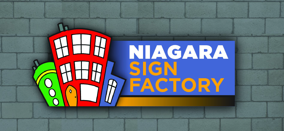

Johnny Best's re-design (I'm looking at his first two) is a nice improvement, too. His is noteworthy for the generous margins around the copy. Graphic designer and author John McWade, in his book Graphics for Business, said, “Wide margins are like fresh linen: they set an open, inviting table.”
A common mistake among novice designers is to view negative space as “wasted space.” Also, micromanaging clients invariably pressure sign designers to “fill up” the sign. They fear negative space, thinking that it prevents them from getting their money's worth. This is misguided thinking.
For good insight on the importance of viewing negative space as an essential design component, rather than merely background, see Alex White's book, The Elements of Graphic Design, chapters 1 through 3.
I once heard a sign designer say, “put more space surrounding the layout, less space within the layout.” It's a good rule of thumb, generally.
