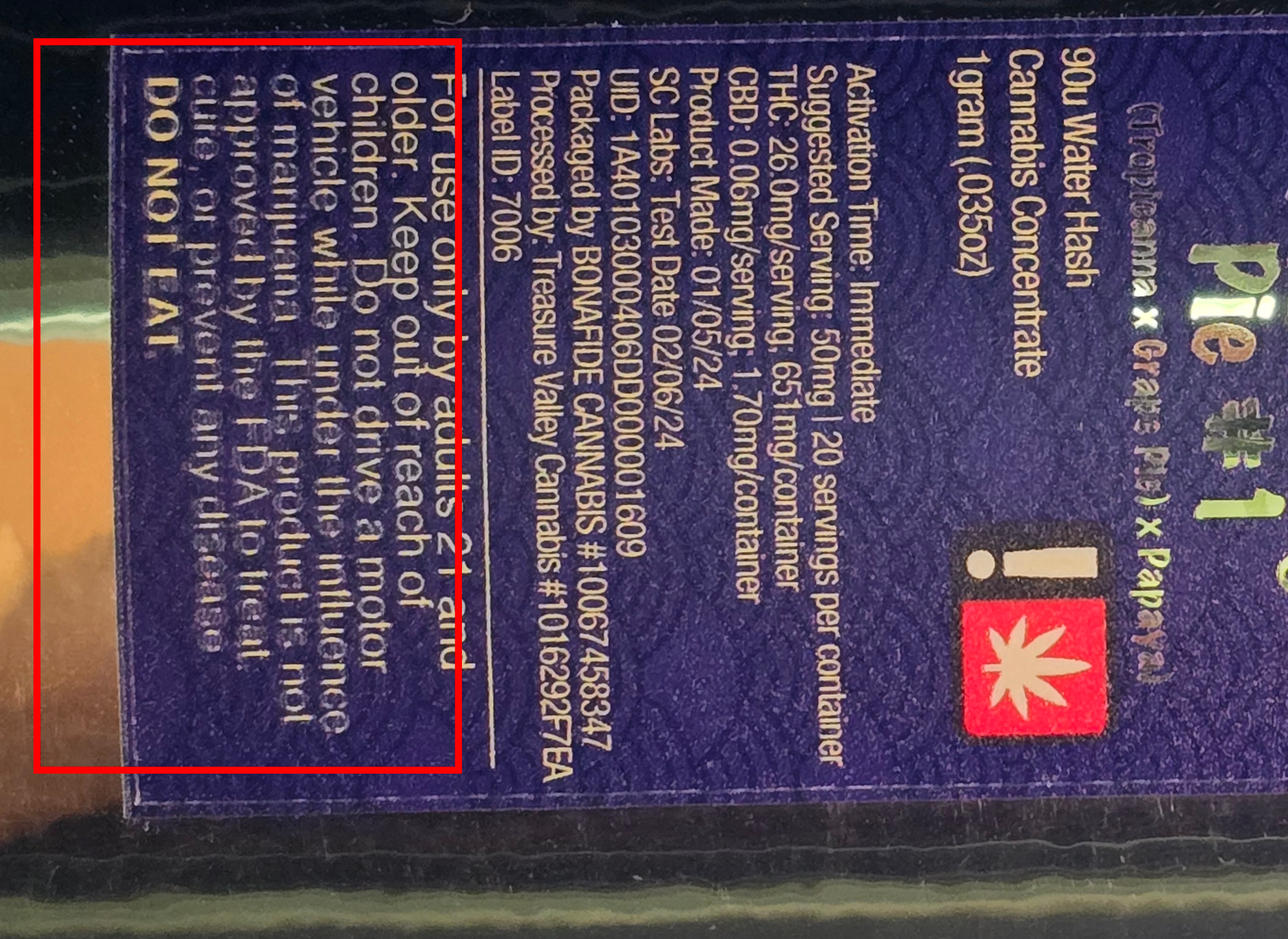

I'm printing client labels on gold vinyl with the Roland LEC2-640 and the final product has some intermittent blurring going on. It doesn't do it with any other vinyl. It seems to effect vertical strips about .5-1 inch wide. They're not always in the same spots. It's not the file, and it doesn't seem to be a problem on any other vinyl but the gold chrome. Anyone have a similar issue or possible solutions? Thanks!

The film is likely not laying flat on the platen in the areas which this issue occurs. If you get down at eye level, you will see it buckles where the blurry print occurs (might be hard to see on a LEC2 with the front covers).
You can print unidirectional in VersaWorks as a temporary fix until you figure out why the media is not staying flat.
