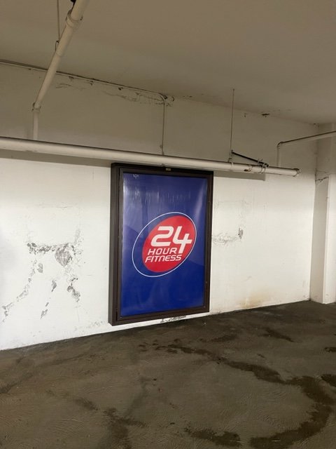

Hey Guys,
I have a shopping mall that wants to convert their old flourescent light boxes to LED.
Anyone know the best way to do that?
Is there a kit available?
How about light placement. Is there a a special way to avoid hot sports or uneven lighting?
BOXES ARE 48"w x69"T
And made of steel with Fluorescent vertical tubes
Thank you for any advice!
