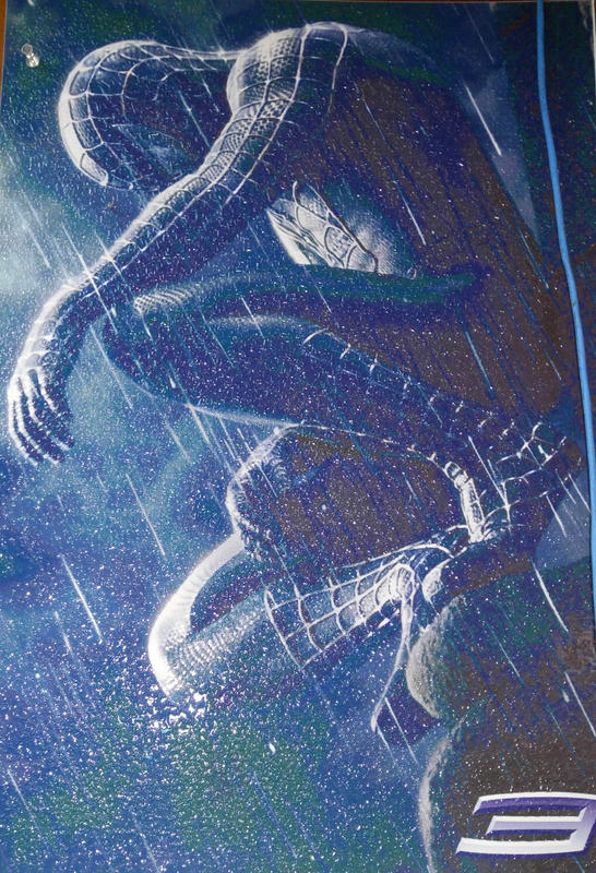

interesting, I wonder how that works.. I have actually played around with that on our old flat bed by running a print with the lamps set real low,
wait a couple minutes, and then go back over the print with just the lamps.. This is a print of a drawing one of our artist did a few years back.

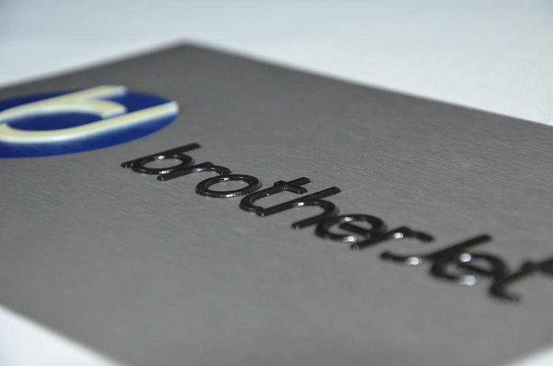

That looks cool. This is apparently what you can do with the LED UV's, I don't have one yet so I can't try it. It's just like DCS's printers.

Yes, it looks cool.
The reality, though, is that you could scrape that off with your fingernail- usually pretty easily.
Granted, I am speaking only from experience with the DCS UV24 (a machine that is a steaming pile of crap), but the idea that it's a feasible alternative to using applique is just ridiculous.
My experience with that same machine also leads me to believe that, were my current employer looking into a new machine (currently our flatbed is an HP FB700), I'd suggest that they insist on talking with others who'd bought the printer being considered (independent of the person trying to sell the new printer) as well as seeing real world demos (not YouTube videos) and being able to test the output against your current printer.
I'm not saying they won't work, I'm just sharing my experience.
