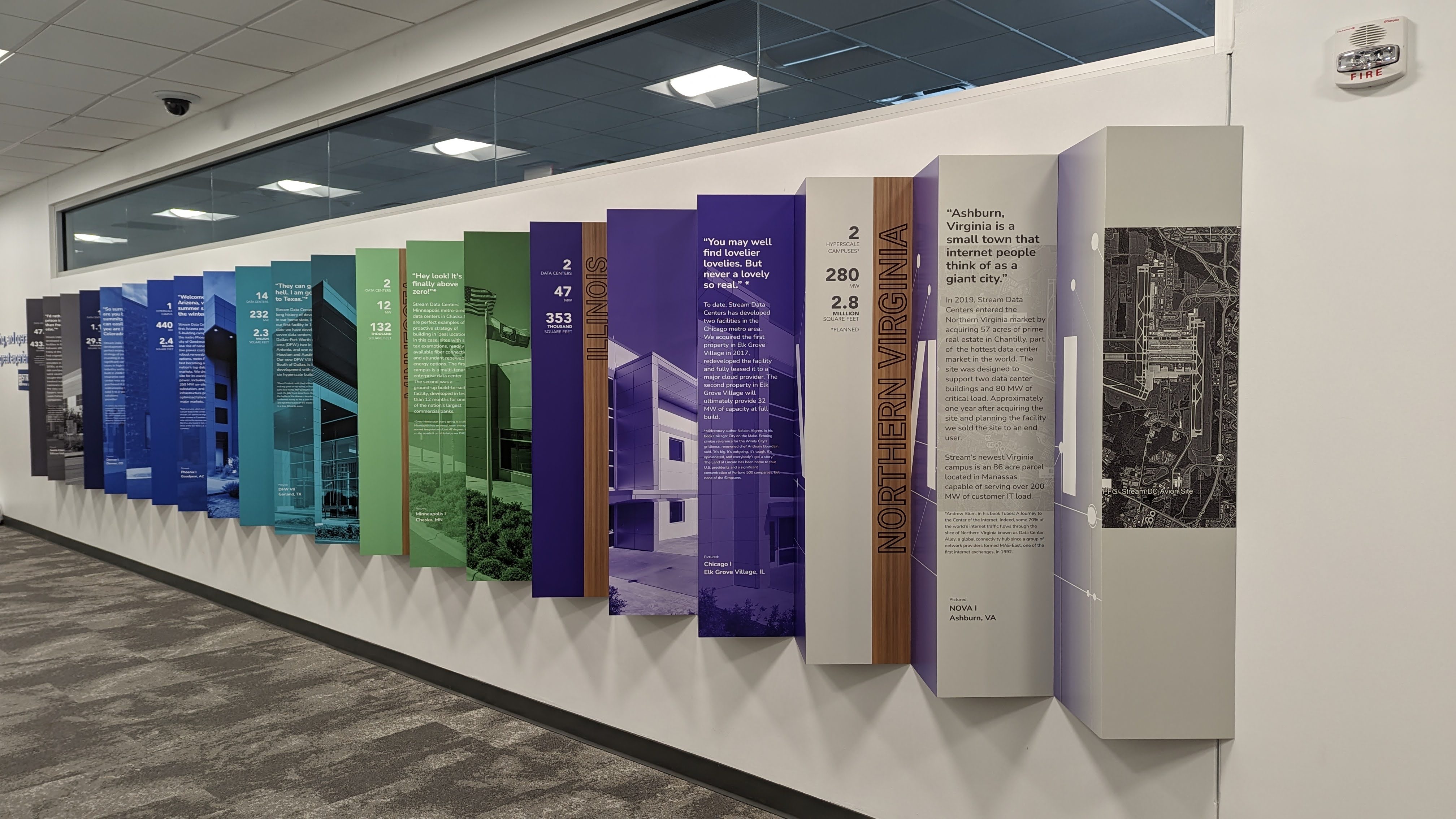

Looks like what they are doing here, but in a non triangular form. I like your example better, somewhat cleaner look between angles.

Yeah, you can go to youtube and look up lenticular displays and we have a bunch of the triangle ones on there that we (Heritage Signs and Displays) have done and we get requests every week to make more. They are a logistical pain in the butt to make and install. The fin type would ship alot easier and be pretty simple to install and change out if ever needed.

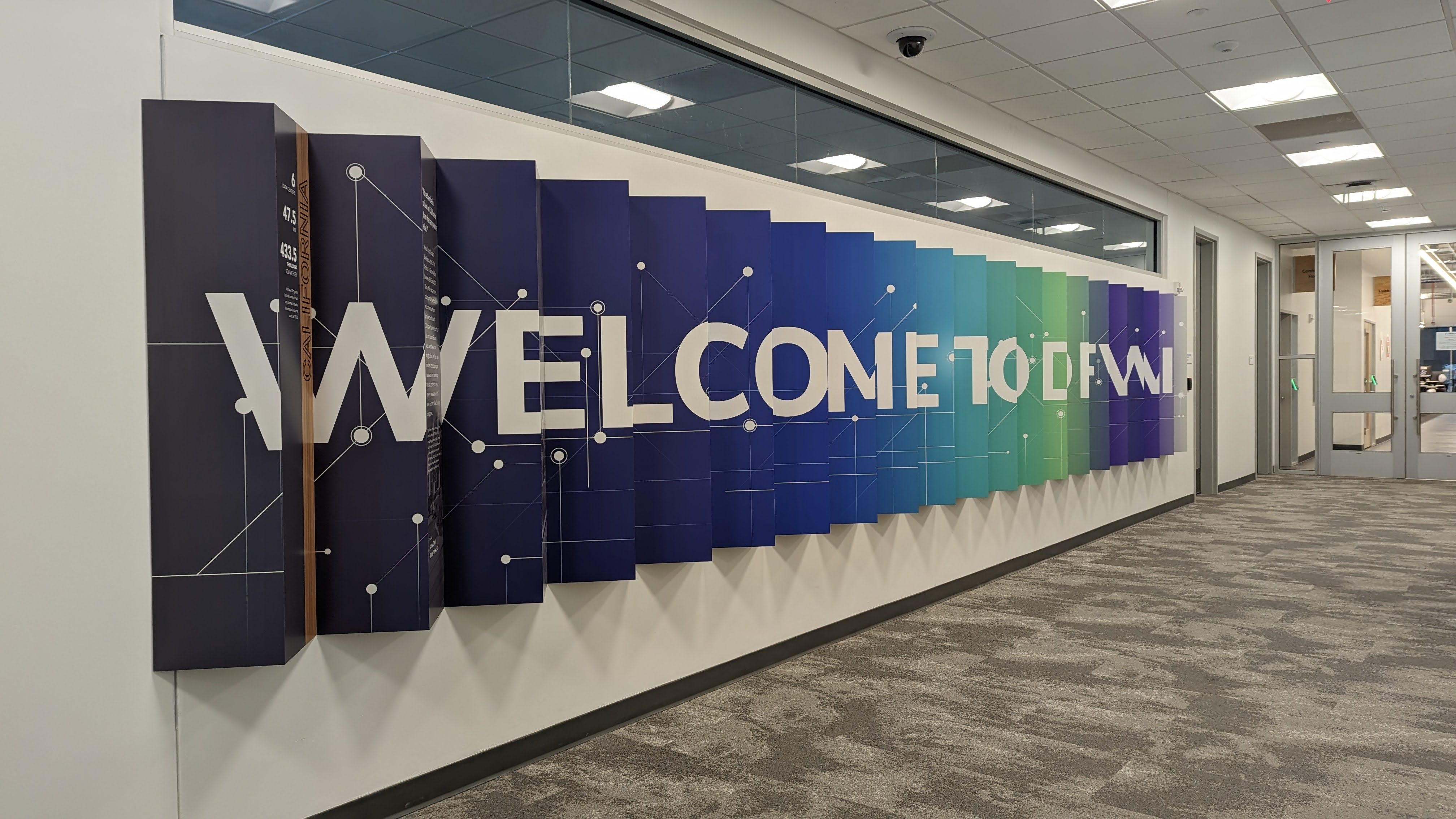

I wouldn't sweat the specifics too much. The graphic basically just continues across each piece as if it were flat They never really read too smoothly.
Installation is straightforward. I've installed quite a few and essentially all have been done with a single z-clip in the centers. You can put clips at the top and bottom but it's overkill and often useless. If the wall surface fluctuates, you won't get all of the clips to slide in, so it's easier just to do the centers.
