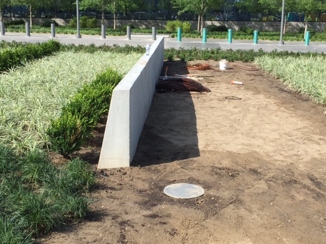

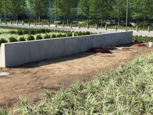

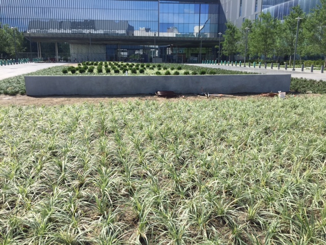

Hello.
We have a customer who wants us to give him some quotes for different options for putting letters on a concrete wall.
It should be relatively permanent.
The options I have in mind:
- paint with a stencil
- flat cut aluminum letters from Gemini + other options from Gemini
- sandblasted with a stencil
What do you think?
Also, if they go with letters from Gemini how to estimate the installation time of a job that size?
Thank you!

FCO / cast letters would look best IMO
install isn't 'that big' and its all ground level.
depending on wording, I can't see it taking more than 6h on site

Sandblasting will weaken the concrete, so your client wouldn't be too happy in a few years if it starts to crack. That looks like a pretty modern building... IMHO brushed aluminum/stainless letters on stand-offs would work well for that wall. Don't give your client too many choices - pick two or three you feel would represent them best and sell them on that.

WHAT IS THE PURPOSE OF THE WALL?
WHAT IS STICKING UP IN THE CENTER OF IT?
WHAT IS THE MANHOLE COVER(white circle)FOR?
IS IT SOLID CONCRETE, OR JUST SORTA LIKE A STACO FACIA?
IF IT IS SOLID CONCRETE.....WHAT PSI CRETE DID THEY USE? 2000 PSI HAMMER DRILL IS FINE.......3000-4000 PSI.......SDS)))

I'd do cast or dimensional channel letter that stands on the top of the wall. The finish I opuld chose would be a chrome or, brushed aluminum or silver letter. That would look great with the mirror windows. This would look the best and add some height to that short wall not to mention help it not getting blocked by over growth of plants.
