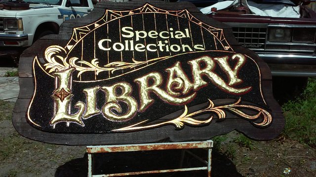

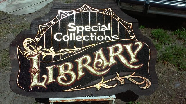

Some of ya may have seen this already so for the rest.
Made from recycled pallets, Be Bond, smalts, imitation red gold & gold, new 1-Shot, Apoxie for library.
Hand drawn, lettered & made in less then 10 hours in 2 weeks.
I have one great customer that likes using gold & smalts & anything else I come up with & the freedom to just go at it.

Craig Sjoquist
Thank you yawl
Yes George only info customer gave me was make it like others, use a older shape, gold, smalts, & some older decorative image.
Searched some shapes, combined a few ideas, the letter styles I was already using on other signs along with colors & gold. so then it was why not add dimension without getting carried away since affordability came into mind, so molding the letters with Apoxie by hand & not doing perfect shaping, & smoothing out made it easy & quick 1 hour, besides a hours worth of mixing & shaping ya hands are tired, it is a 2 part epoxy clay that ya mix for a few minutes by hand.
Also I knew I had designed in alot of gold which meant outlining it all ( even simplified that as I painted in the size ) before smalts is poured on, just seems to look better & sharper when done.

So historic look indeed even the recycled pallets are not perfectly lined up, letting a bit of warp show fit well with rough letters.
