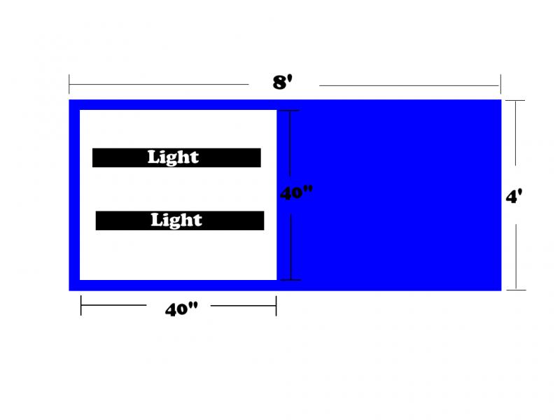

DizzyMarkus
I was thinking something along these lines -- lol colors are not correct :0) sizes are. I expanded it to 40" and threw a quickie together
Thank you,
Markus
