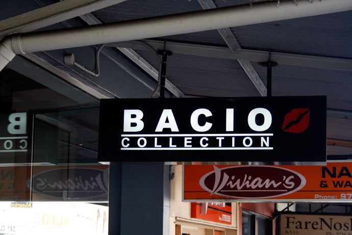

Opaque vinyl is fine in this instance because at night you only want light coming through the lettering. Avery 5500 series black is opaque anyway. Eg.
(not my sign)
