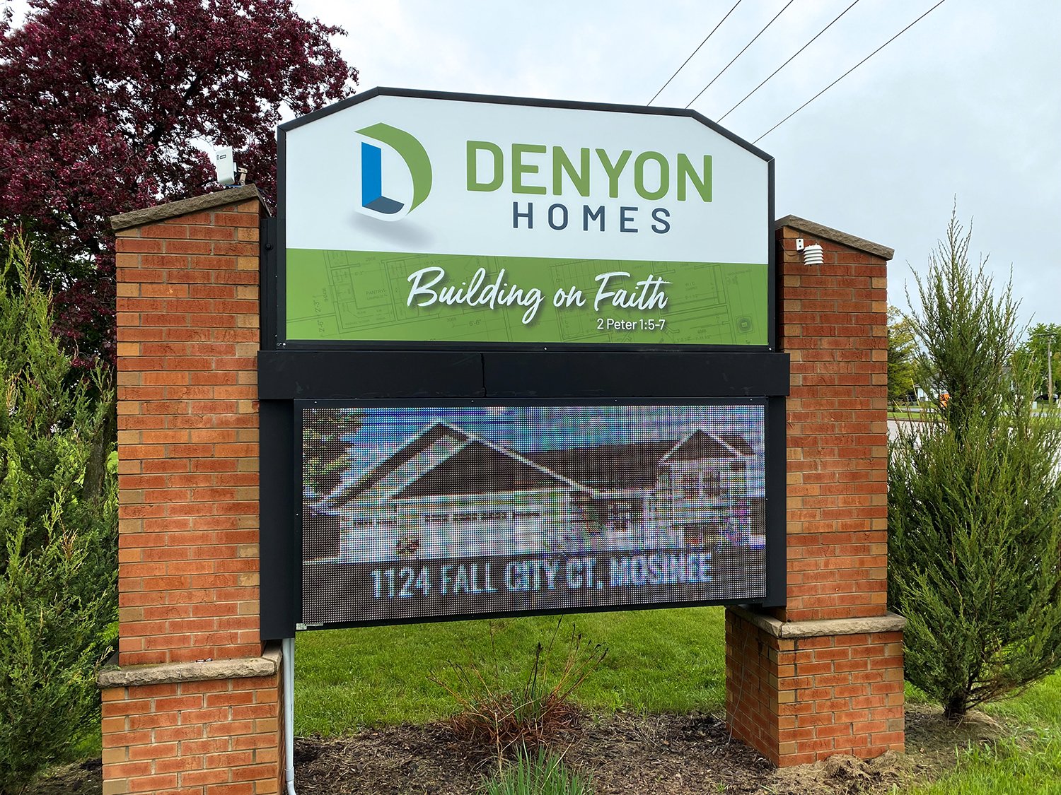

We use a variety of methods based on the need. For ones with good LED lighting I'll sometimes do the white polycarb panel with printed translucent on front, same/ mirrored on back, and it works good. If it's an older refacing with not so good lighting, I'll do clear mirrored on the back. This is an 8 foot I did recently with LED lighting, don't have a night pic of it, but drive by it enough, and it looks good lit up, colors match good. Translucent was printed on a Mimaki Eco-sol, no special settings, no overprinting, I just do high number of passes so it's all even. 284111990_5338811429508403_8507091793197799630_n.jpg
