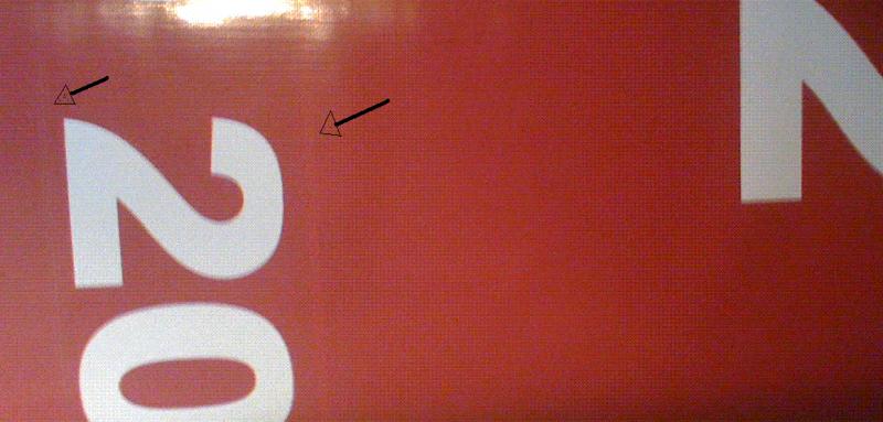

I using a XC-6540 POR 3.
Everytime a print something, the printer put 3 differents lines in the midia. blue, yellow, it still continues while printing
Anyone helping resolve this problem?
Constantino.

Are these lines down the length of the print or across the print.
I have had similar appear down the length of a print. It has happened to me where the media has lifted slightly from the printing plate. The difference in height of the head over the materials can at times print this way.

I Did put high in the head height, but still with the same problem, the lines continous to appear.

Does it do that on just that file you are trying to print or all files?
If just on that one then:
It looks like the line is a box around the 20 as if it was a line of text or numbers that was dropped over the existing background but the color does not match up giving a line effect around that box of text or numbers.
If you put an RGB file over a CMYK the colors are never exact and will always show even if you used the eye dropper to match color.
Just a shot in the dark.

Looks to be pinch rollers, we used to get them when printing on thick Roland banner material. Make sure your middle pinch rollers are either lined up directly under the alignment guides or completely away from them. Kinda hard to explain.

I had the problem when i had my heaters ... mostly pre heat up to high.. might try to turn it down a bit
You never stated what media you are printing on, try another medai with the same file - you may be surprised that its the MEDIA that's the issue (cheap).
