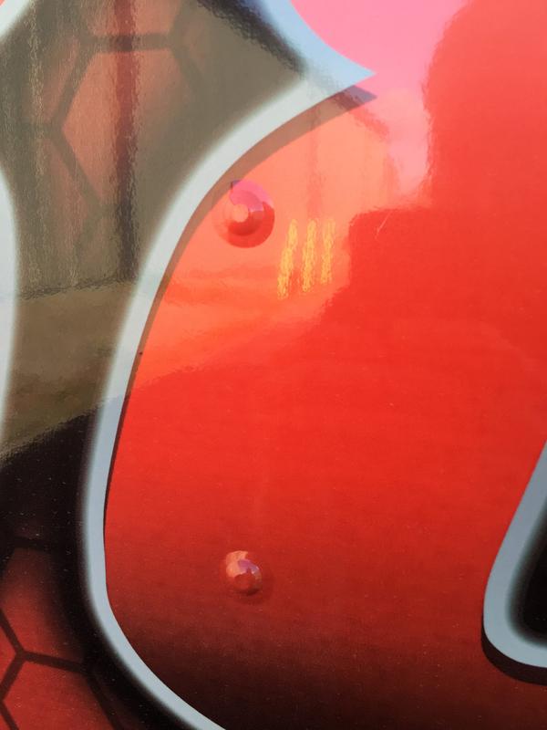

I did a wrap a few weeks ago and saw it last night. Around the screws it is starting to lift a bit.
We installed it doint the rollie pro or the foam paint roller with channels. Used torch and heated down.
We also went over with a squeegie and poked a hole under.
Any ideas how to fix this. I used 3mij180cv3-10. I was recommended to try avery 1005 would this keep it down?

Did you use 3M 94 Primer all of them?
It really helps to prime them and any other deeply contoured areas. A couple of tiny pinprick holes to allow the trapped air escape can't hurt either.
We use the 3M Rivet Brush and a felt covered squeegee to work on rivets and screws like that.

I would have went over with a rivet brush but it would poke a hole in the center of the screw where a bit would go to remove screw.
We didnt use any primer 94. Is that what most people do?
SightLine
That depends on whether you are the sort of shop that your customer comes back to in 3 to 5 years to get it re-wrapped. Primer 94 on 1100 screws..... :banghead: No thanks. Our customers come back and I'd rather not charge them more for the removal than the install because we have to scrub the adhesive off of a thousand screw heads. On install, poke them a few times with a pin, brush the main bubble out, quick hit with a torch and brush again to get it nice and tight up to them, final harder hit with the torch and rivet brush to set the memory. Only takes a tiny bit longer on the install and works great.

We remove the screws or cut them out. I haven't seen many full wraps over trailer screws that aren't lifted like that.
d fleming
Yeah, it looks so sexy all bubbled up underneath :smile:. Nothing says you have to put the old screws back in, use pretty new ones. You don't remove all at once, do it as you go.

I feel like the wrap would look bad if you had all them screws showing. Trailer was pretty old so also didnt want to remove all of them in case it made it less sturdy.
They're little screws. Nobody but the terminally anal will notice them. It's the proper way to do it.
ExecuPrintGS
So there really is no way to fix what I got showing in the picture for a 3-4 week old wrap?
Removing them is the only way they will hold long term. No material can bridge that gap/ angle and hold.
If you really don't like seeing the screw heads, we have in the past painted them to match the print if it is a mostly solid or minimal color changing background.
For example on landscape trailers with the bottom half grass, we would pick a green in the print and paint new screws ahead of time. If the top is blue like the sky, paint them blue. It at least camouflages them a bit.
It is a lot more work, and more money buying new hardware but if the customers are that picky about seeing or not seeing the screw heads they can pay for the extra labor.

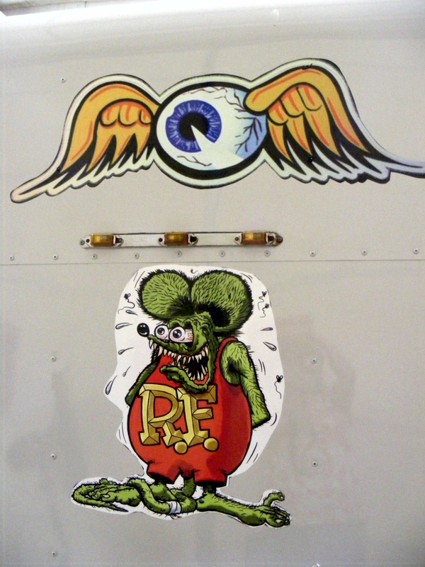

just did this one.........with SQUARE DRIVE .....

these ALUMINUM framed trailers, with ALUMINUM SHEETS.... attached with STEEL SCREWS arent made to withstand years of vibration. the ones that are POP RIVITED......are more durable. especially the 3/16 or 1/4 inch rivits. as for what i did REMOVE.... and REPLACE.......they were not removing the whole panel row.
in this pic we took out 4 to lay the print down, stuck em right back in
