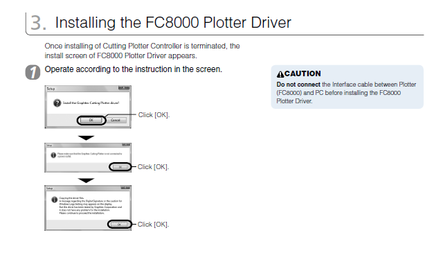

I'm pretty sure your plotter should not be connected in any way to your PC while installing drivers, at least Graphtecs.
Upon further review....see attached.

blufftonsignguy
After finally getting a phone call back from graphtec tech support today, he seems to think my firewall is blocking me from loading the software. I was logged in as admin so that couldn't have been the problem. I feel sure now it was the firewall blocking me, but as usual, I couldn't get a phone call from them while I am in front of my computer, it has to be when I am away from it and can't get back to it to solve the problem. Thanks for your advice though, as always it is very much appreciated!
