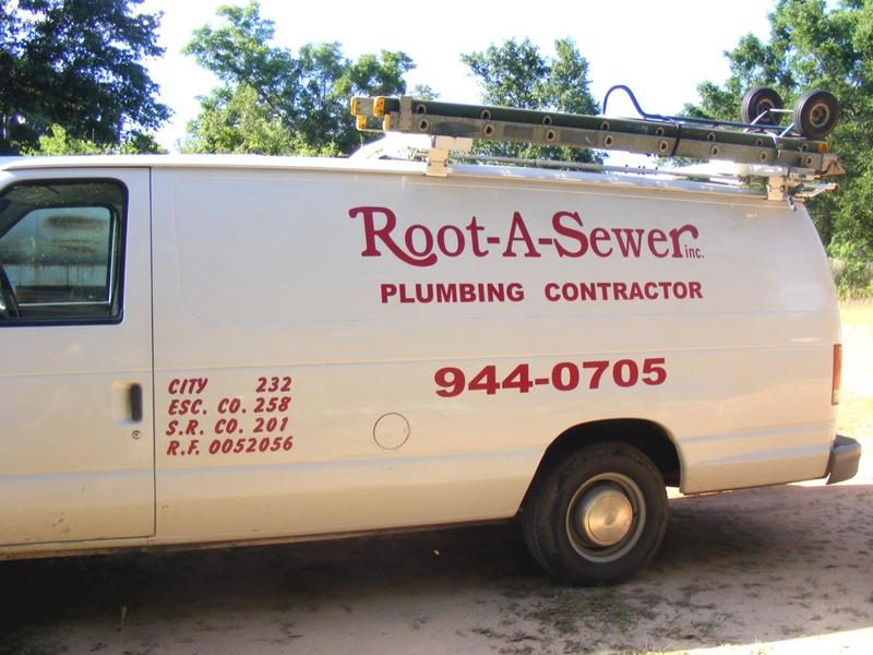

i did 2 of these van in 2001..........with avery HP vinyl, the one with the silver backing(high dollar)red out side.
they are outside 24/7/365 in florida sun. i recently did another truck(2012)same vinyl. when they are parked next to each other.......NO DIFFERENCE i depth of color)))))) amazing.......14 YEARS.........
