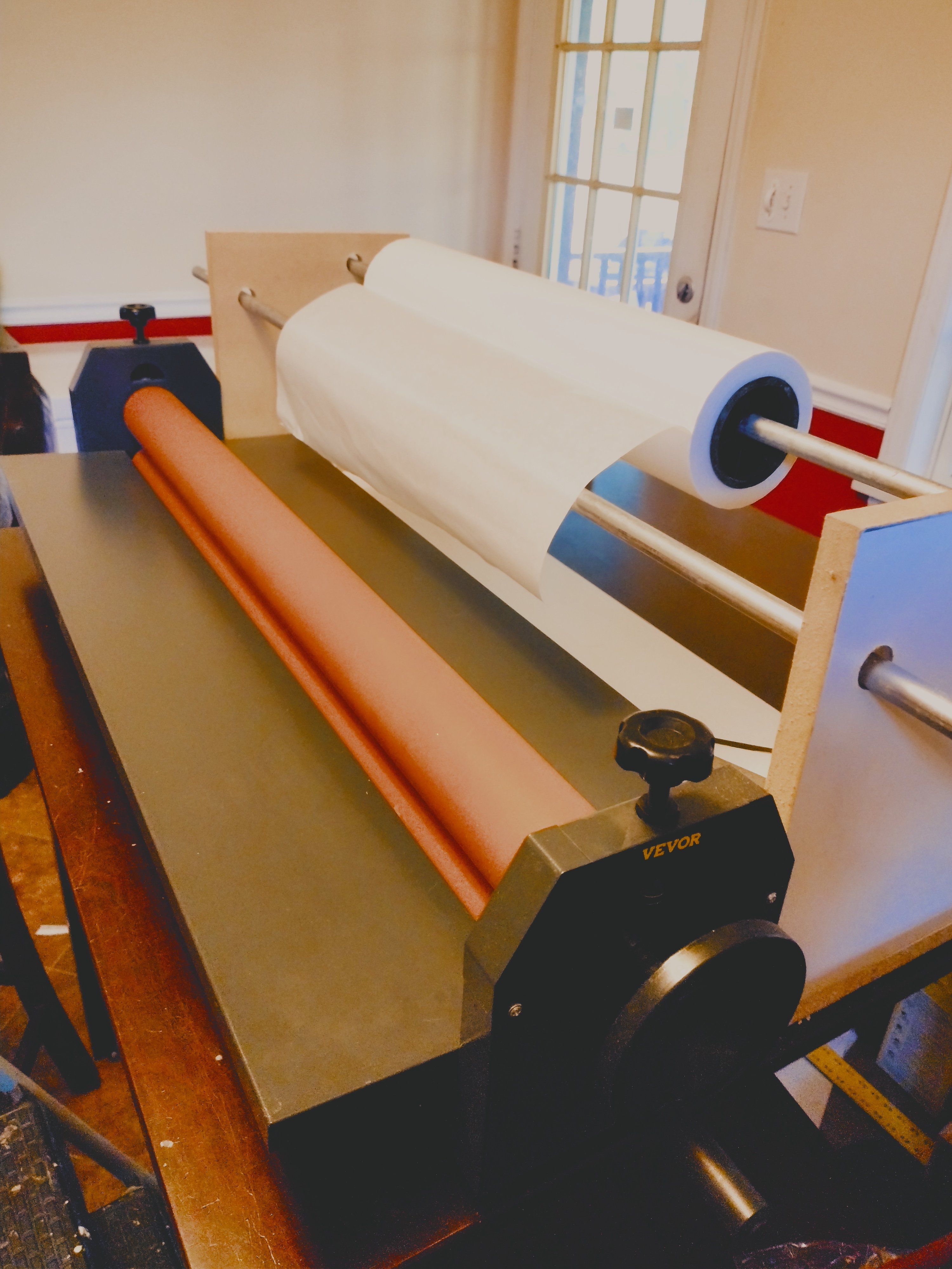

I just recently got the 39 Vevor manual laminator, and it surprisingly well for mounting small jobs, like 18x24 coro signs. It does not work well for magnets, too much steel for the magnet to stick to. I tried using some cast laminate for some license plate prints, and got a few bubbles but I think with a bit of practice I may be able to laminate small jobs. I built a roll holder to go with it and it works great for applying transfer tape. I taped over 100 feet of cut vinyl with no problems. My only complaint is lifting the top roller. When you unscrew the tension screws it only takes the pressure off the roller, it does not raise the roller. You have the hold the roller up with one hand while loading some ith the other hand on some materials.

Thanks for the details. Did you tried to mount film on a 4x8? If yes, how it went?
