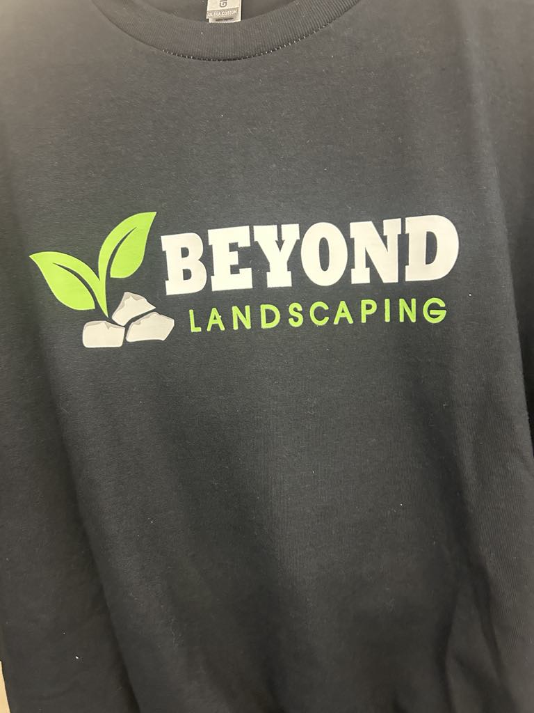

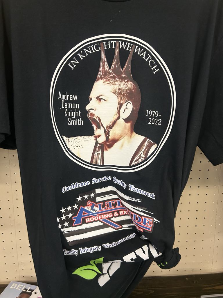

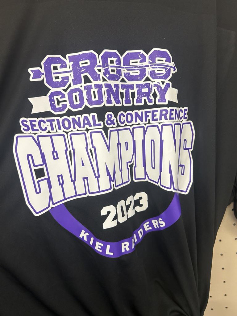

I buy DTF transfers that way I can put them on anything. They are not super cheap but you can put them on gang sheets. I currently use Supacolor and I'm very happy with them. They are easy to apply. Preheat a 3 seconds, apply for 10-12 seconds then quick press for 2 seconds with Teflon. They work much better than Transfer Express. Here are a couple samples. If I order them Monday I often have them by Thursday/Friday.
These are all Supacolor
I had some issues with supacolor transfers not adhering properly. Not sure if it was just that batch, but l had to switch suppliers because those little errors messed up the whole job and l lost out on $300.
I like how Supacolor screen prints a white base and digitally prints on top. Check out DTF SHEET DOT COM if you haven't tried them. Their gang sheets are way larger and they ship the next day as well.
