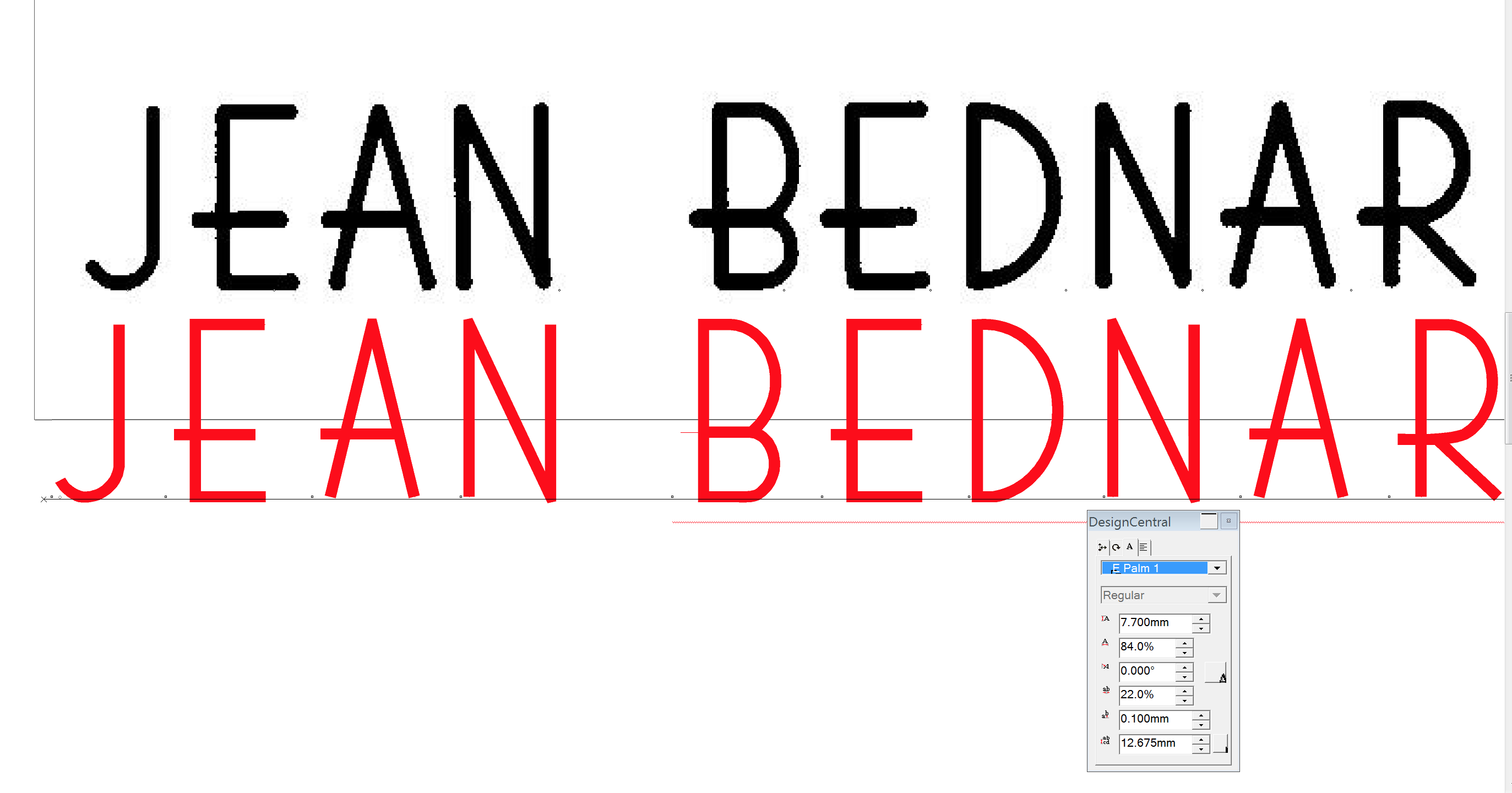

I have a CASFont E Palm 1 looks similar. Can be used in FlexiSign.

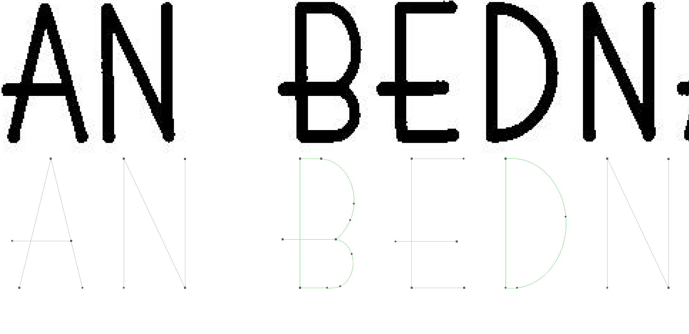

That's likely it, if OP actually scanned the engraved plate then it has rounded terminators naturally.
Attila Nagy
Just added stroke to it with sharp corners (did not show properly with the 'B', but it is a single line Engraving font for CASmate, Inspire, EnRoute or Flexisign
