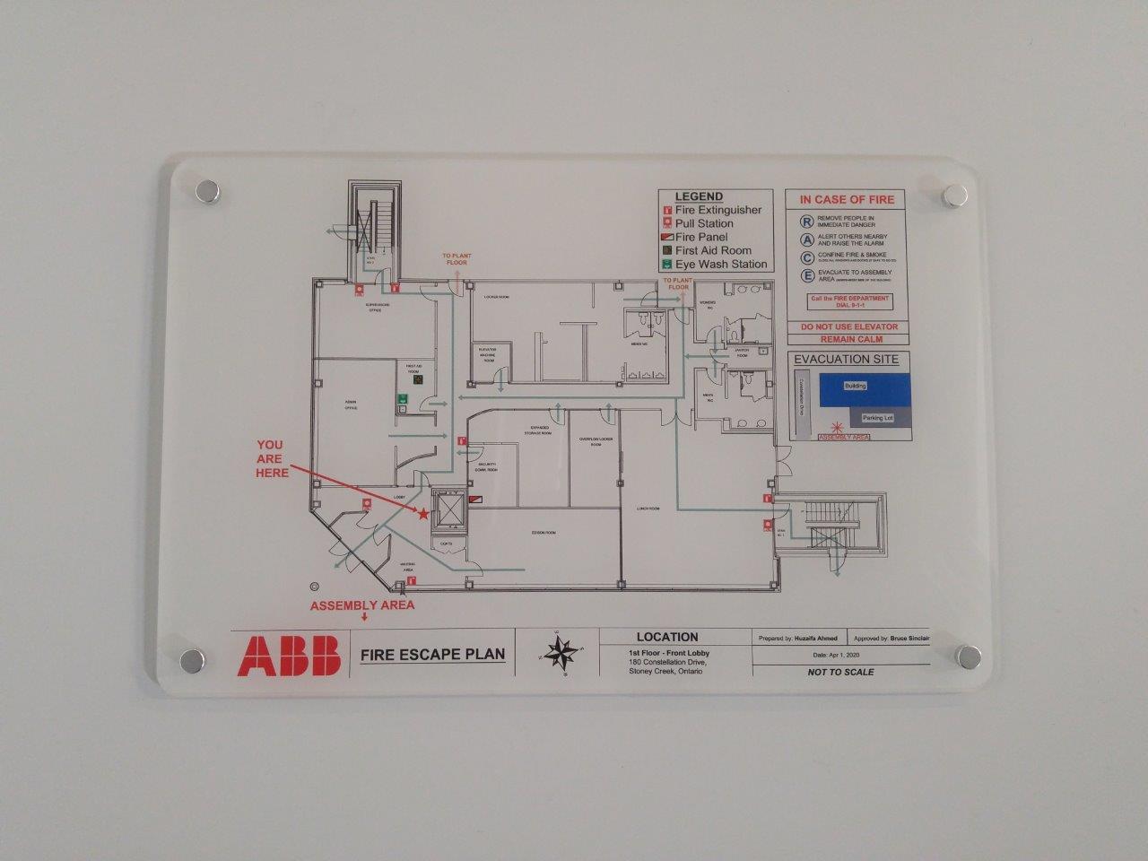

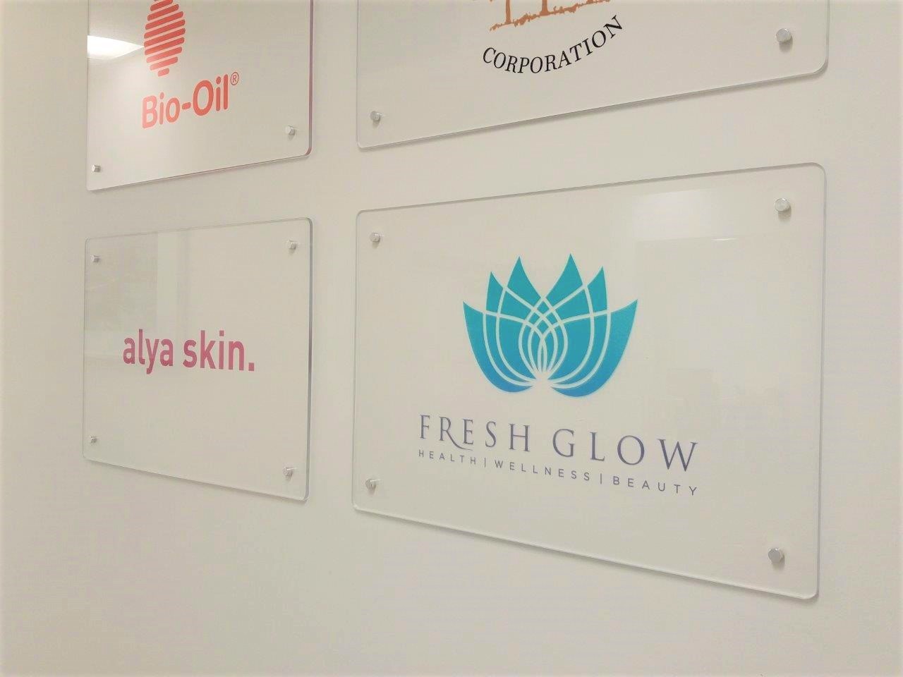

For indoor signs, I reverse/mirror print on Oracal 3651 Transparent, and laminate the backwith clear lam or white vinyl. The adhesive on the 3651 is not optically clear, but the results are fine. I like the 3651 because the adhesive is solvent-based, and allows for wet application without any fogging. It's also a removable adhesive which makes stripping and reusing substrates an option. I've tried a lot of different clear vinyls over the years. I also like 3M 40CR-114, 3M IJ3650-114, and 3M IJ180mc-114.
