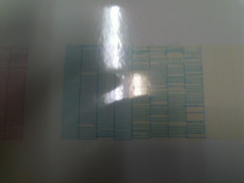

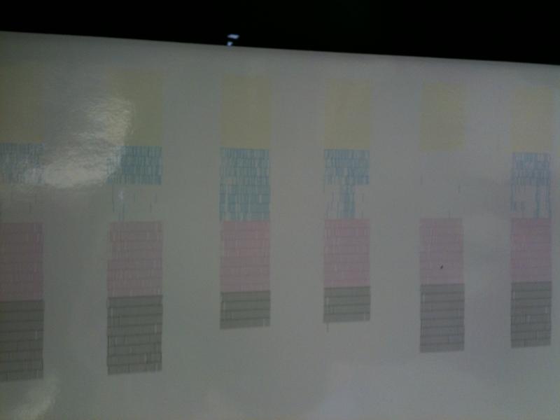

JV3-160 SP Left channel of cyan is barley there during nozzle checks.
Best guess it is the slider board. Here is what I have done so far.
- Replaced Dampers, O rings, Manifold, and Head cables.
- When I did the data cable swap at the slider both channels were there, looked odd though, cyan printed over yellow, and there was a blank swatch? Which makes me believe the head is good?
