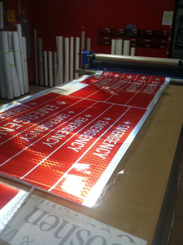

Avery Dennison has a new product V-8000 Visiflex. It's a prismatic printable vinyl and should be cuttable , but no gaurentee from me
DirtyD
A buddy of mine at another company used it..here isba pic..
