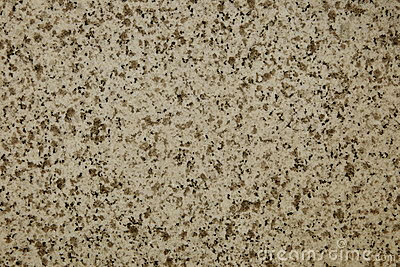

Not having much luck find a good seamless tile to use for this background for a wrap. It's for a company that does the epoxy floor coating in garages, etc.
Maybe I'm just not using the right combination of search terms???
Here's something close I found on Dreamtime but it's not a seamless tile.
Any ideas?
Thanks!
MikePro
heck, just make your own? doesn't have to be seamless tile, just make a rectangle and add 3 layers of vectored noise in different colors.
signswi
The image in the OP is 99% seamless already. Buy it, offset filter it in photoshop, select the tiny line (barely visible) and do a content aware fill, repeat for the other axis. Done!
I just did it to your file in about 5 seconds to confirm but I'm not going to post due to the obvious copyright issues.
Mike is also right, you could make something like this in mere moments with noise.
