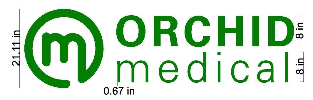

Looking for someone who can duplicate the process shown. Stroke too small on letters for fab metal, but needs to be illuminated.

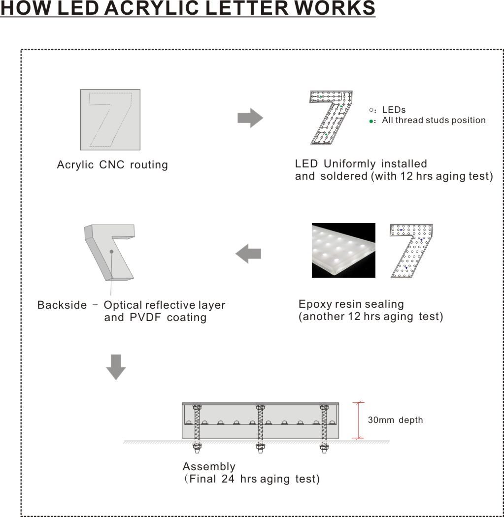

Looks like the method uses
1" acrylic, routed down 1/4" depth, with LED diodes wired in sequence, then filled in resin
Specs:
1" thick white acrylic
LED light projection on front and rear
Painted sides
2" threaded studs/spacers for mounting 2" from surface (drywall)
Hollow tube for carrying wire to rear of drywall, with 6' of wire for each letter
Power supply

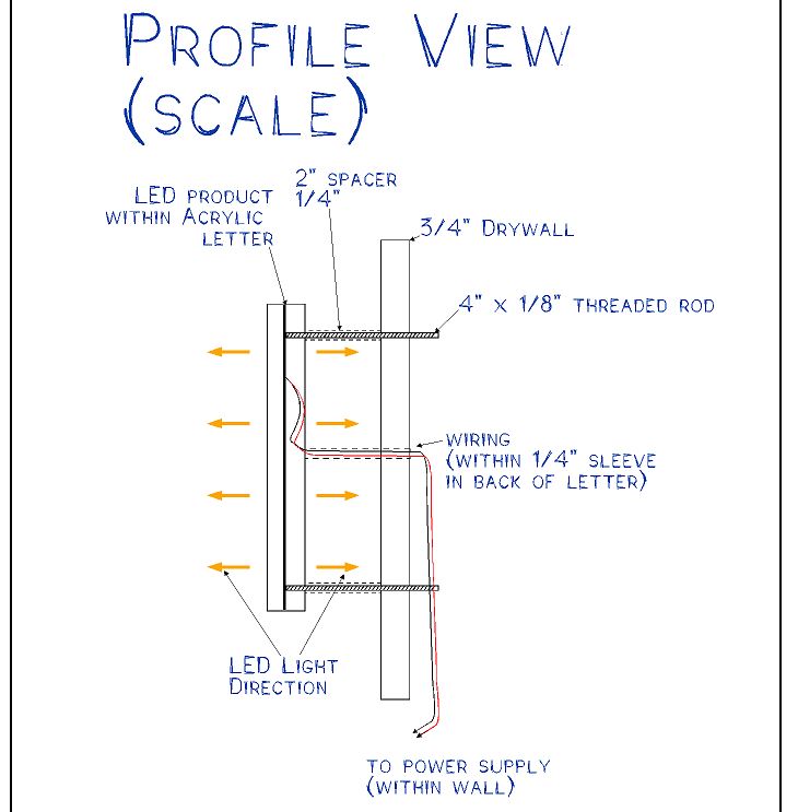

Drawing for it:
Sent it off to the reccos - thanks guys.
