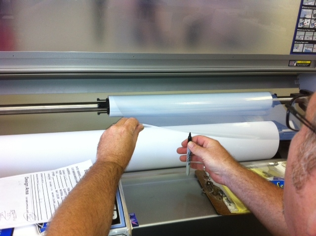

d fleming
Try taking a fat sharpie and running it down the leading edge of the film. Then load it.

Thanks! I will try that; unfortunately the sharpie did not work.
