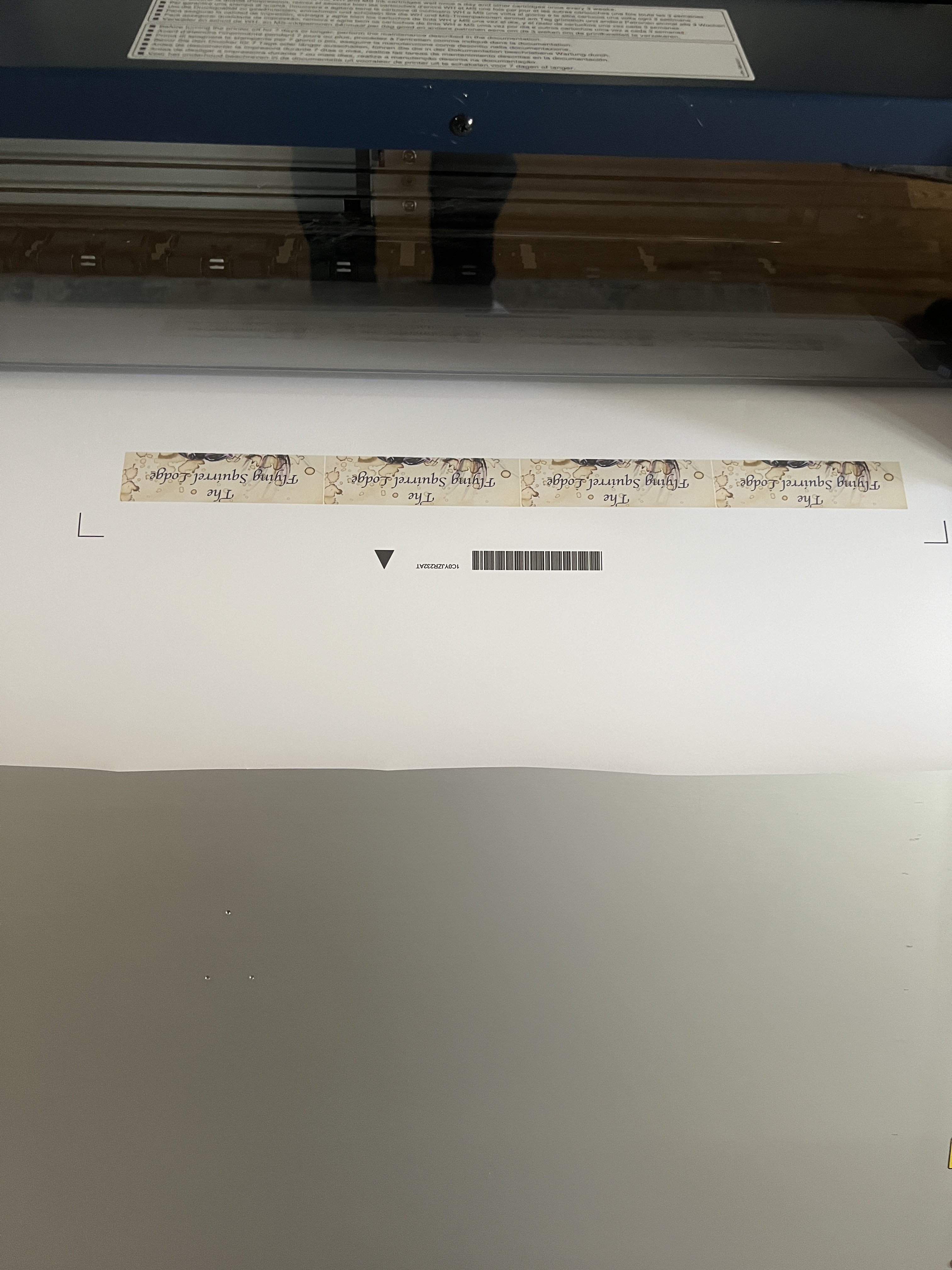

Dan Berg,
Are you able to successfully print the Onyx Evaluation PDF found in the Onyx Sample folder?
No, I looked and have no sample folder. Unless I am looking at the wrong place. Now the problem I am having is the printer starts to print and then stops with only a small portion of the print completed.

Dan Berg,
Cannot print the entire print cut sample. It prints 3" full width and then stops. Seems to be doing that with all files now. then it runs about 3' of material on the floor and then prints a very small strip. Something seems to be corrupted.
