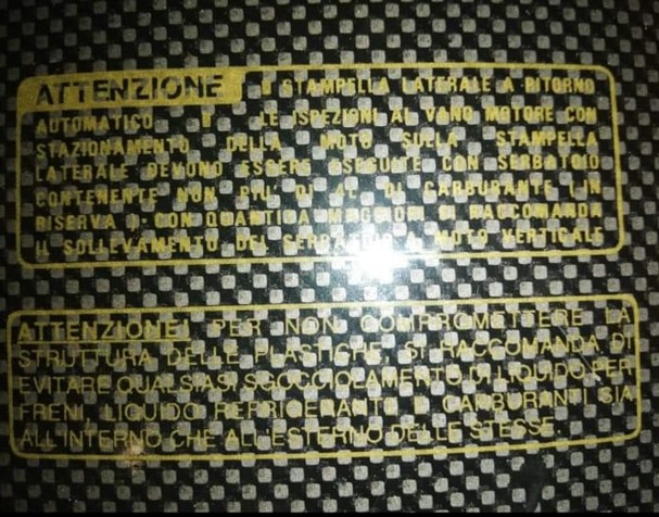

Hi, i need to make some print with Gerber over vinyl kind of fiber carbon.
I know i can print with my Gerber over many materials not certified by gerber, as ive tested before..but ive never tried with carbon fiber....
Have you ever tried or done this kind of job?...any material reccomendation for this?
i know some people they print directly the carbon fiber squares with black and grey over white regular vinyl but i dont want, i want to print directly over carbon fiber material...show an example...
Any help please? Thanks in advance.

thank you Fred, appreciate your help, wow many colours!!!!! thanks, though i prefer to print onto it directly if possible...have you ever tried that?

I have printed carbon fiber but do not recall ever seeing a ready to use carbon fiber vinyl.
