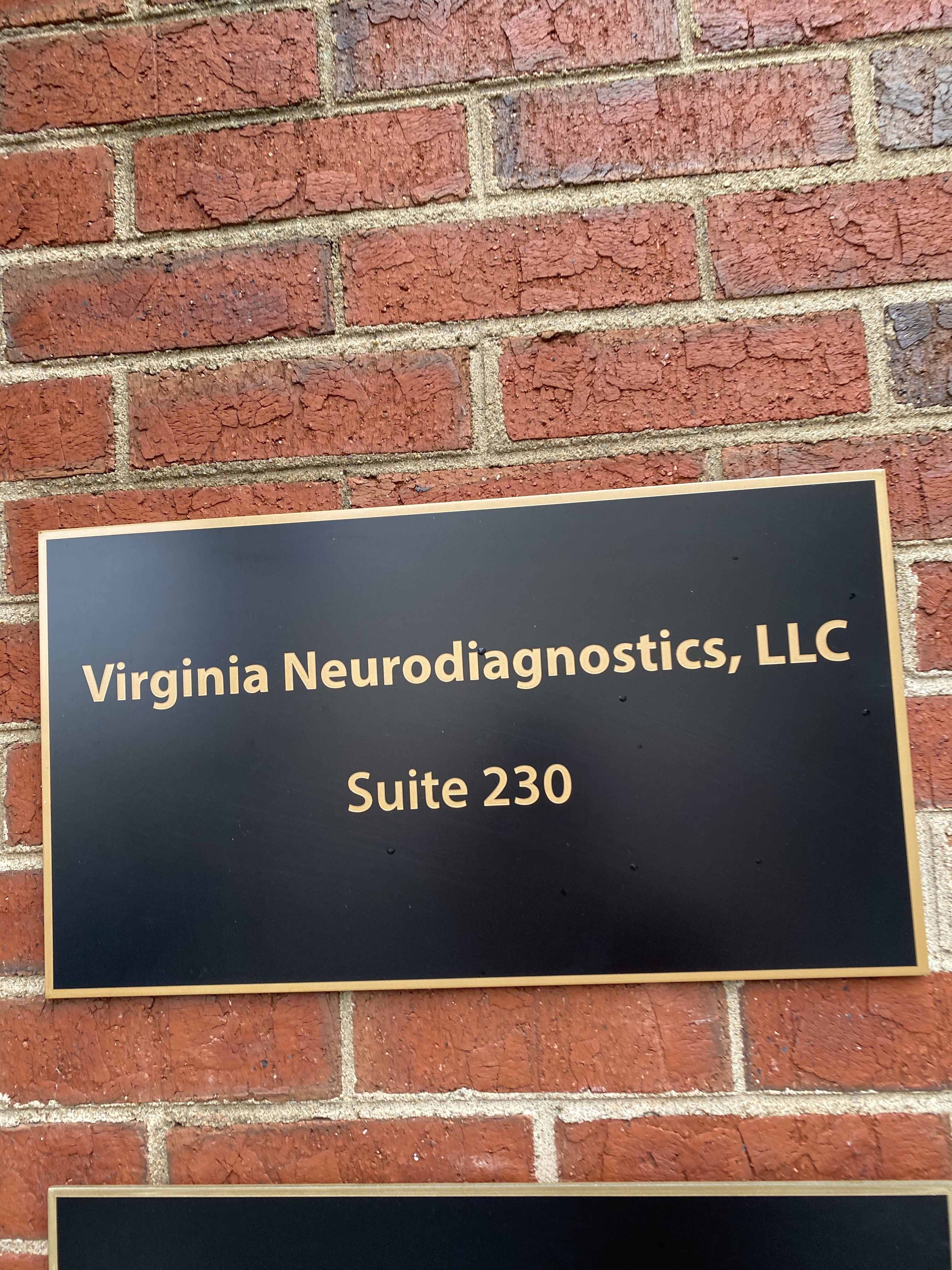

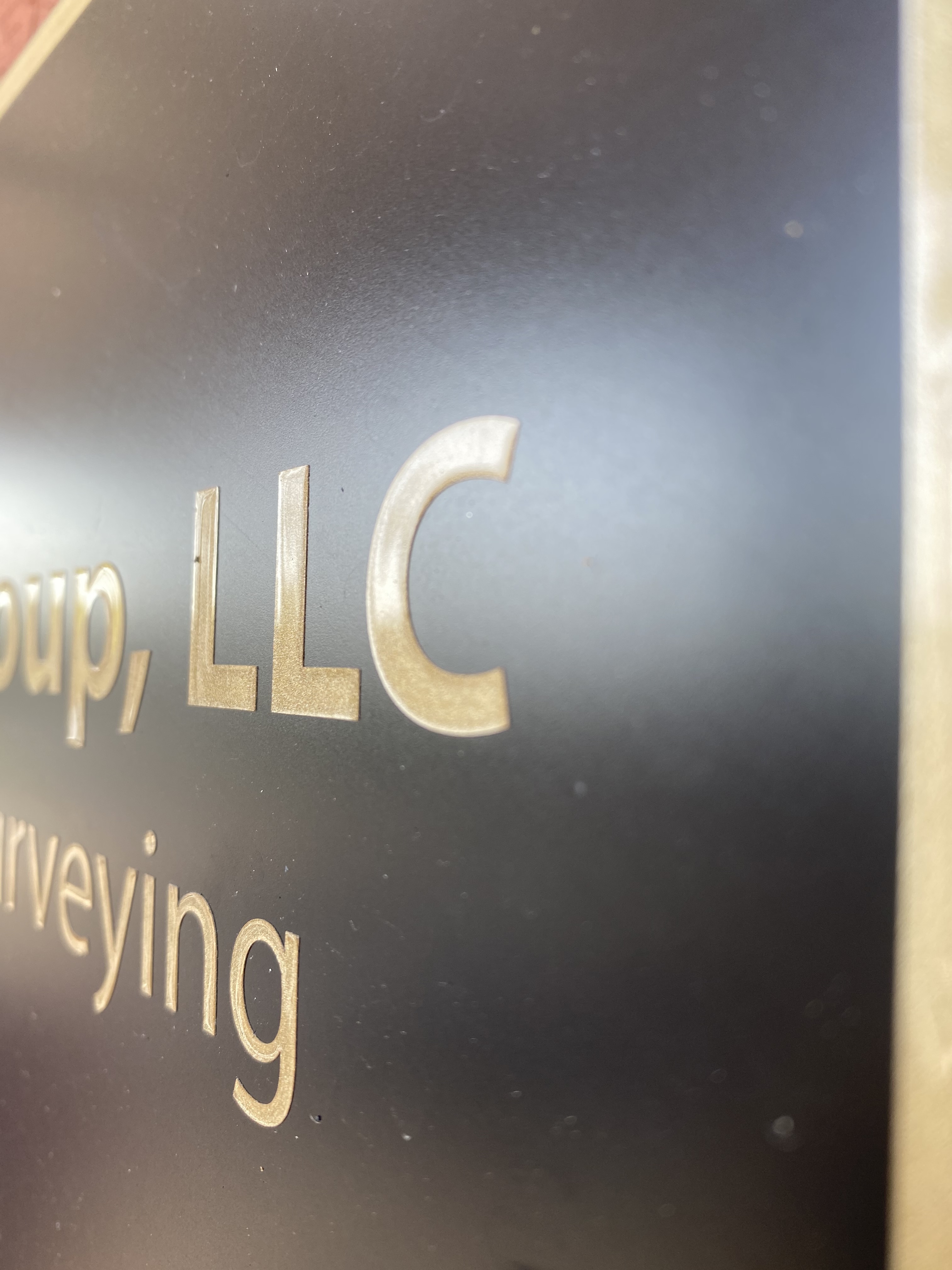

I have a client that needs to match existing signs on the building. At first glance they look like a cast plaque from Gemini. On inspection they are engraved then the engraved part is painted gold and filled with a clear epoxy giving and embossed appearance. If anybody has a suggestion I would greatly appreciate it. Photos attached.

Do you know what material they are made of and what thickness they are? I can't really tell from the picture, what type of edge do they have?
It is either 1/8" painted aluminum or acrylic with square edges on the outside of the border.

I know, about 17-20 years ago, I used to get a 'doming gel' from (I think) Coastal Enterprises that accomplished exactly what you're describing. Of course, I'm not sure if CE is the correct company, and I'm not sure if it's still available, but, if you can find it, you will have your solution.
Bricoleur
Looks like poured polyurethane over cut vinyl. Some suppliers once had "doming kits" available for purchase. When applied to cut vinyl, the surface tension in the urethane would cause it to stop at the edge of the weeded vinyl making a "dome" effect. It does require some practice and it can be tedious but not difficult. I was able to achieve this with some two part urethane from one of the large home improvement stores but I would not trust it for very long if using outdoors. This may also do the trick: http://www.richardsonsupply.com/rapidome-doming-kit.html
