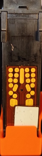

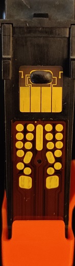

No, the chip is separate.
For science I tested how to "move" it. Just remove it with a sharp blade. It only has a very slim double sided tape to it. Mark the right position before taking the old one off.
After I put it back it still stays there pretty solid so it might not even need the mighty super glue.
This was 792 head but as far as I know it the chip is exactly like this on 831 as well. I just don't have any scrap one laying around right now.
