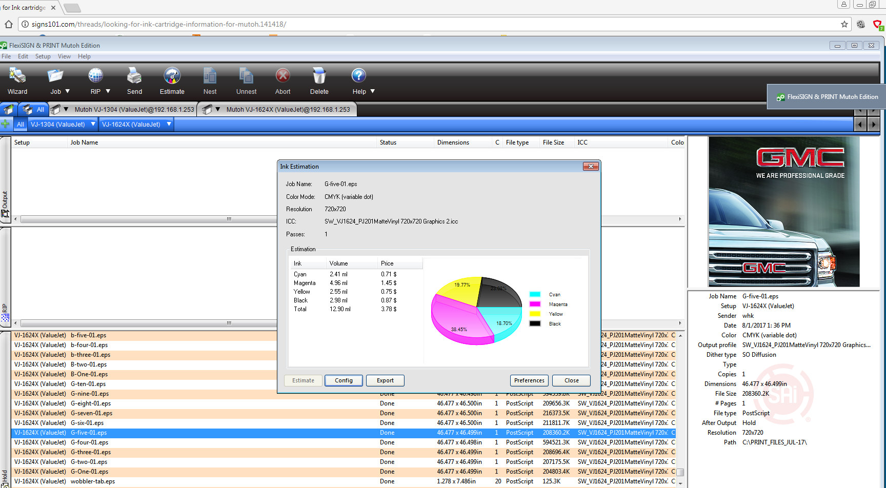

If you are driving your Mutoh with Flexi you can use the estimating option. Lots of info pops up when you run it after ripping a file. Not sure how accurate it is but it will be closer than trying to get info from other Mutoh users. The numbers change a good deal depending on the layout and what settings you use to run them.
If you don't use Flexi you could rent it for a month - load all your old print files -rip them and check the numbers then average them out for a base number. Would only be 50 or 60.00 plus the time to set things up.
wayne k
guam usa

Mutoh unofficially quotes $.26@sf on ink. The Flexi estimator is very inaccurate, use the one in the Valuejet Status Monitor instead.
