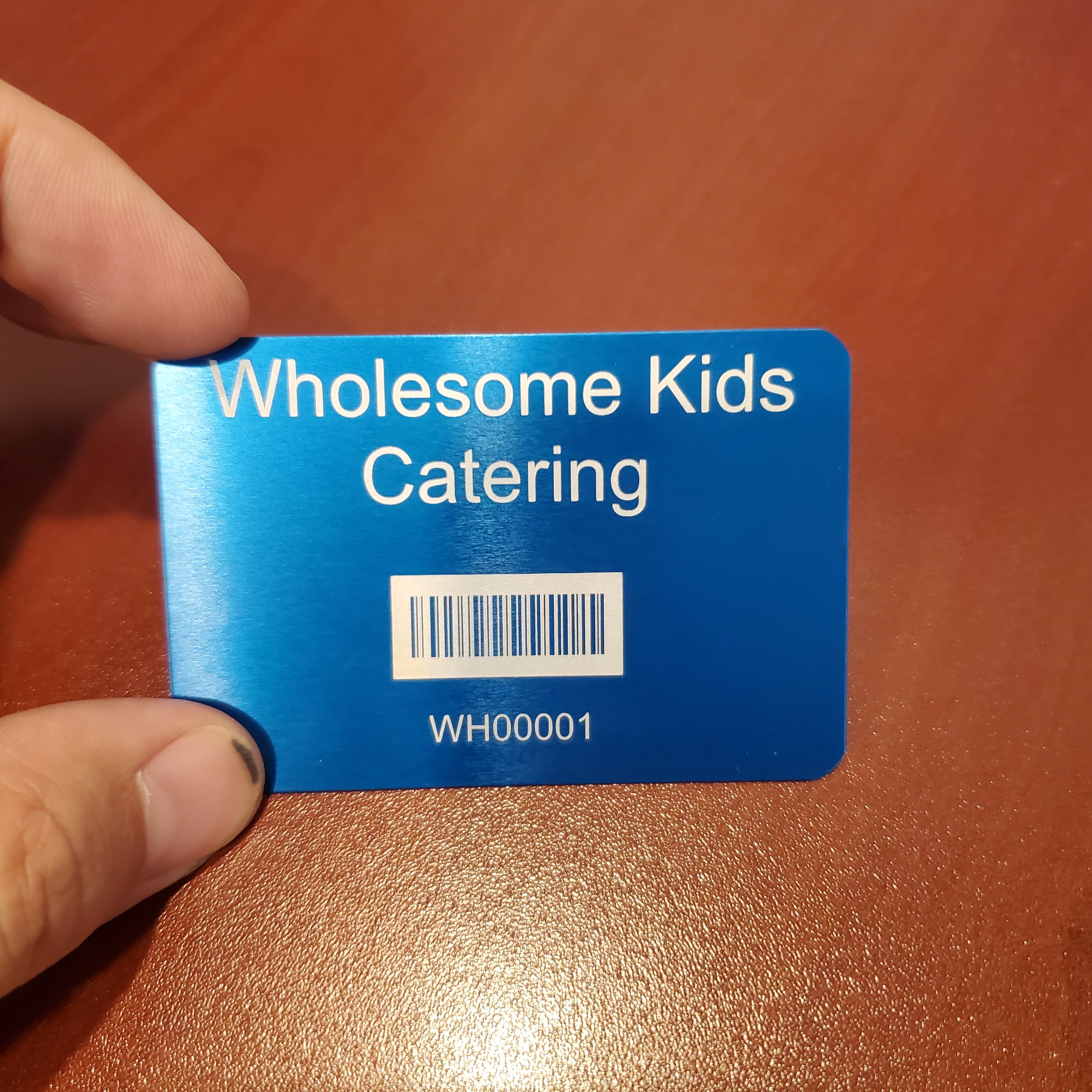

a laser engraving shop could do these easily out of red annodized aluminum, when engraved the text comes out white. If you can't find anyone I could do them but i'm sure there is someone closer.

Yeah, Im thinking they just want anodized aluminum / thats been lasered... Pretty standard, and lasts a lot longer than a print does. We do thousands of them for an oil company who needs to tag their flanges and have them last... ours are out of steel though. A fiber laser makes quick work out of them.

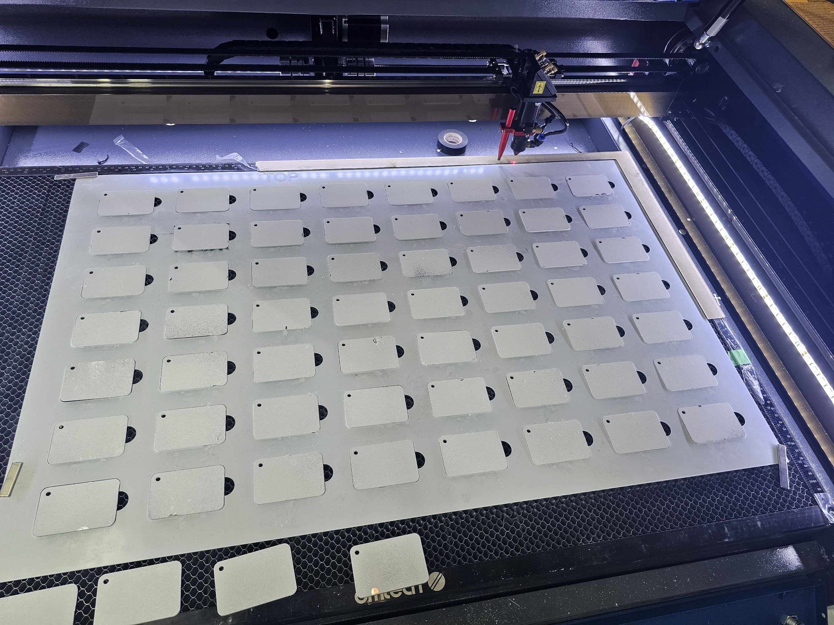

Just finished my job of 500 tags. Ignore the crappy spray job on some of them...I remove the bad ones and re-spray., hence the row at the bottom - I do a quick throw them all into the jig, then I make sure they're all aligned, that there is spray in every part thats getting lasered, and swap out the bad ones for a re-paint.
Took 1.5 mins per to laser them with the spray - So a sheet of 55 took 82 minutes. 9 hours... Lets say 10 with spraying and washing as I did it while it was lasering... One of the benefits of a big bed, an hour and a half between cutting = spending 5 mins to wash + pack, then watch TV for an hour :roflmao: Where as on my Fiber, I could get maybe 10 on the rotary jig...
Fastest I could get it on my Fiber with a nice black was 6 mins per - Or 50 hours.... The deepest black, 16 minutes per. The fiber is a nicer engrave though, Much more crisp lines in the small text. But again...What theyre using them for, And the fact I have to have them look like what we were previously getting, I'm stuck with the spray method on this job anyways.
I have an extra 50 tags to play with though, so I'm going to use them to mess with the fiber more.... I don't like how the ceramark / brilliant turns out, it looks a little spotty in the bigger areas, and its not as sharp text as the fiber is.
