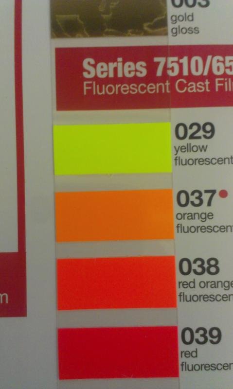

029 oracal yellow fluorescent. Maybe laminate it with 3m 8518 and get a little more green tint to it?

Team Valhalla
Thanks for the insight Z Signs. I'll need to find more sample charts, because after going through the ones that I already have on hand, they weren't satisfied with what they were seeing.
We're gettin' there.
