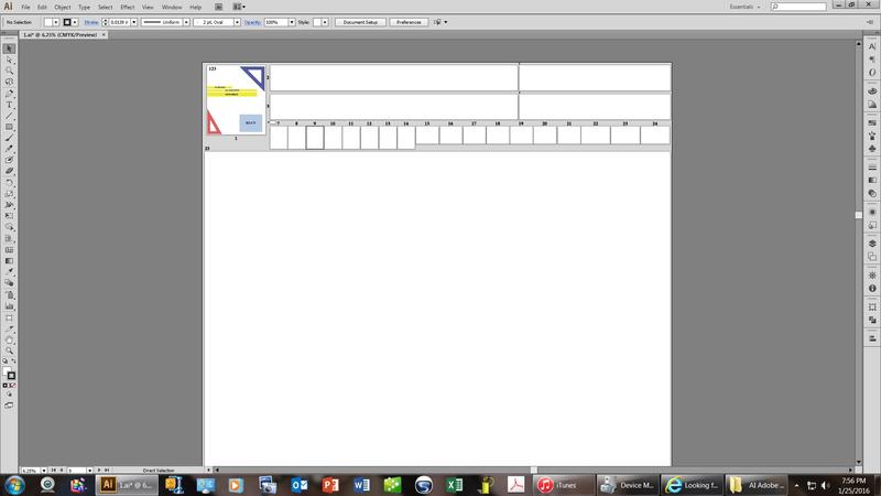

We've taken that concept and went one step "simpler". We use the multiple art board feature in Illustrator so we only need to deal with one file for everything artwork related: mockups, proofs, full-scale artwork, artwork approval forms, photos, cut-files (we do vinyl cutting only), etc...
We export our cut files as .dxf for plotting, and we save the individual art board documents as .pdf files to email to our client. Each art board is its own entity, and Illustrator allows you to export/save them in several different formats...individually or in groups. The template shown contains 25 art boards of various sizes and orientations (landscape/portrait). The art board for our watermark logo is only 2" x 3", so it's a little hard to see in the photo.
Documents (approval forms, etc...) are printed on either letter or legal size paper.
Up in the far left corner, I've created a few old school drafting tools (scales, triangles, etc...) for help in re-sizing photos for full scale work.
