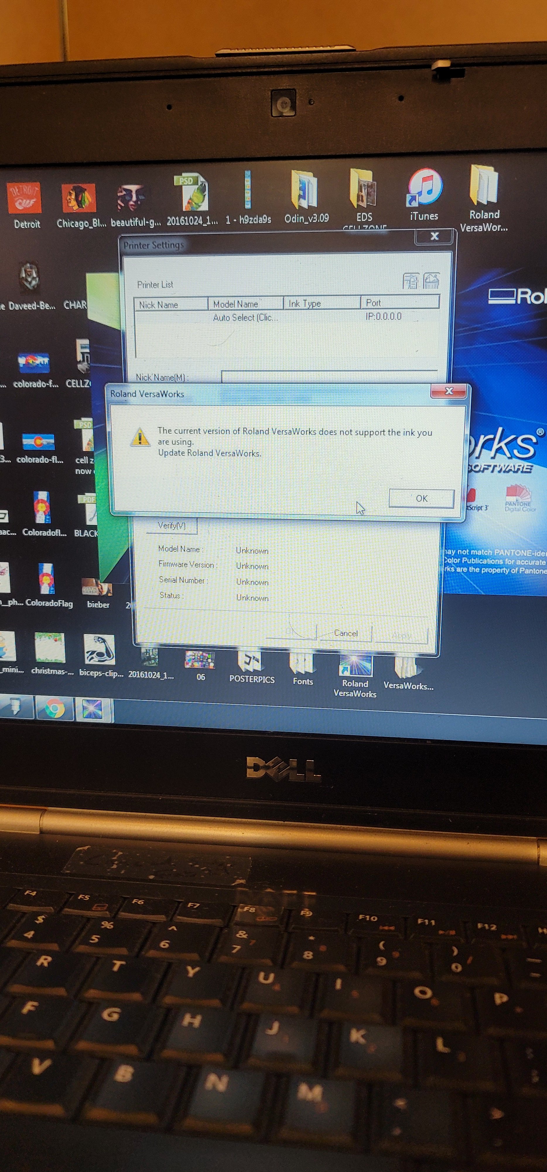

Hello I have sp300v and versaworks can't verify the inks. Please help
