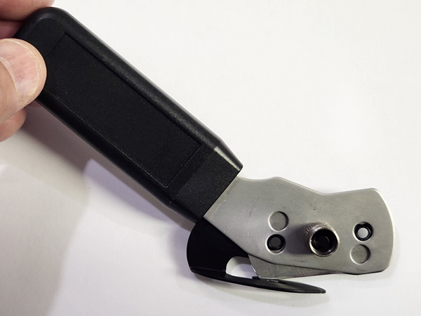

I’m looking for tips and suggestions for making good butt seams in a multi-panel floor graphic. I can’t cut directly through the material because the knife scratches the black marble tile floor.
I’ve done many single-piece floor graphics, and many wall murals with overlapping seams, but this is my first time installing a multi-panel floor graphic.
The material is 3M 40C-20R with 3M 3645 laminate. The graphic is 25’ x 12’ overall and will consist of six panels, each 50” wide (plus overlap).
Since I can’t cut with a knife, I’m planning to use the tool pictured. I’ve been practicing on scrap material, but it seems to stretch the material slightly while cutting, so the seam ends up with a very slight overlap.

I'd just practice with a freshly snapped blade on the same material you're planning on using directly on the floor. With a light touch and practice I don't see it being a problem. Wrap installers go through similar training when they can't use knifeless tape on vehicles.

I was going to mention knifeless tape, but I haven't used it on your concoction of vinyls. They make a type that's specifically for butt joints. Look for 3M™ Knifeless™ Tape Tri Line. Watch some videos.

I hadn't thought of knifeless tape. Good idea! I'm not sure it will work with the 3645 laminate though. The stuff is 8-mil and tough as leather. I'll give it a try though.

Do wrap installers actually cut through vinyl using a knife without marring the vehicle's finish? I don't think I could do that.
