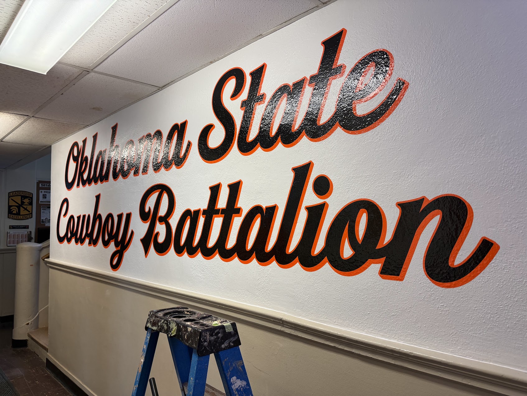

+1 for finding someone with an S80600 or similar. I print a lot of stuff for OSU -- Pantone 021. No CMYK printer can hit that -- but with the S80600 (and custom profiles), I can nail it, no problem.
I have no idea which trade suppliers are offering eco-sol printing these days -- seems like everyone is running UV, Latex or hybrids... all of which are CMYK only (that I know of anyway -- 6-8+ color in UV/Latex is probably out there -- I just haven't seen 'em).
Ignore the gloss laminate -- I did not want / expect to use gloss -- but it was a specific request by the client. Anyway, just check out this orange...

I bet so. Where I am, there's one main orange everyone uses (021), so I only need to keep a few profiles on hand for that. On the flip side of... the S80 almost does too good of a job (especially with the color depth achieved on IJ175/180). You bring a finished piece to someone's office. It looks amazing, but doesn't match any other orange in their office because their other suppliers are just using CMYK. Customers forget what their actual colors are supposed to look like. :big laugh: So you break out the Pantone swatch and show 'em that you're the only one printing the correct color. That's always fun. :)
