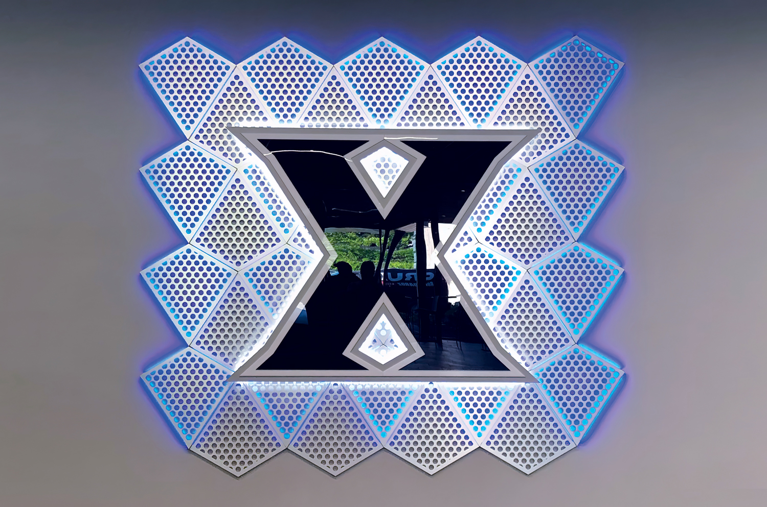

We have a Vision CNC Router. It does a good job and is pretty reliable. The software that comes with it is not for 3D/contoured routing, but you can upgrade to it.
There is a little bit of a learning curve to using a CNC, but overall it is not too different than a plotter and most of the errors are on the art/setup end.
We are constantly coming up with new ideas and products we can make with it.
Attached is one of my favorites so far, 100" x 90" multi-layered dimensional lighted sign using Polymetal, PVC, Acrylic, and LED lighting.
