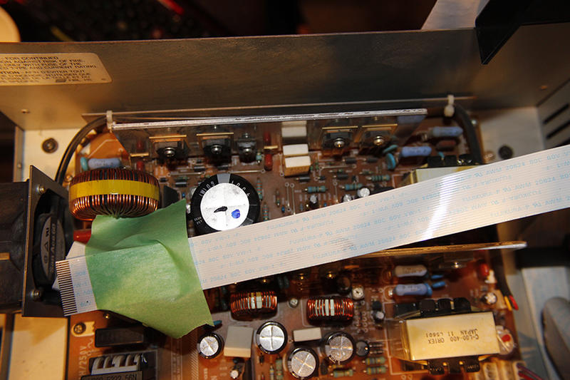

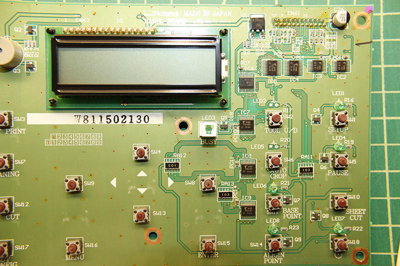

I pulled the display menu board and gave it a good cleaning. And while I had things opened up, did an internal dust removal as well.
I tested the cable with an Ohm meter, and all contacts were working, so put everything back together and it was fine thereafter.
