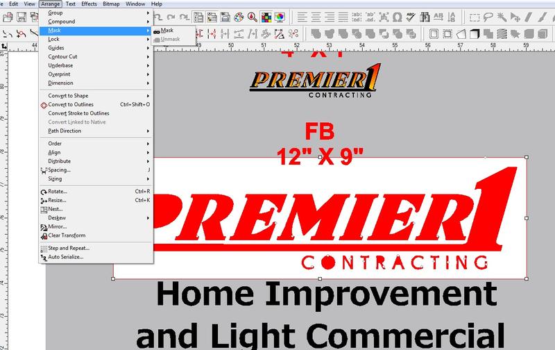

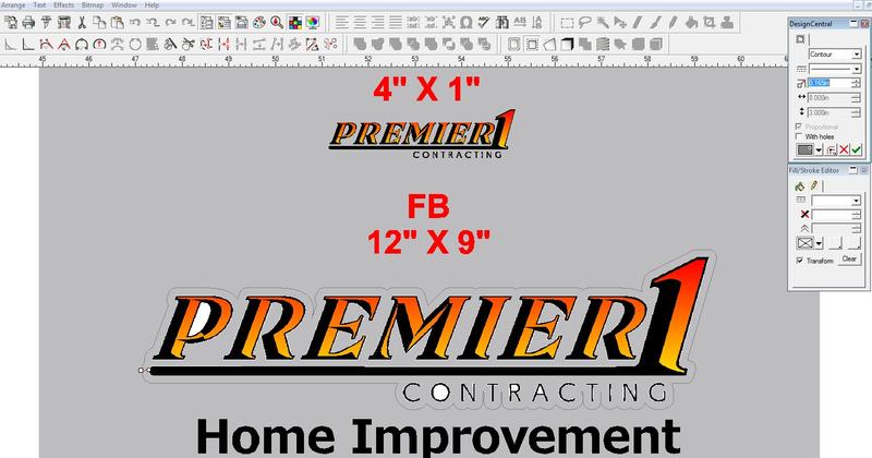

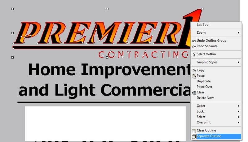

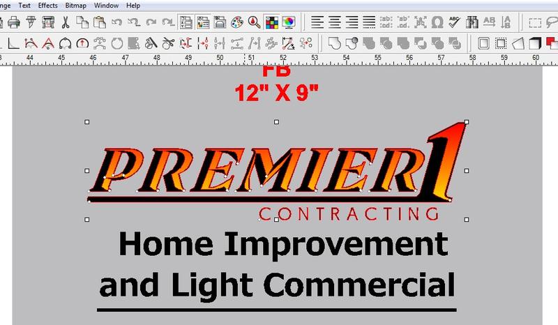

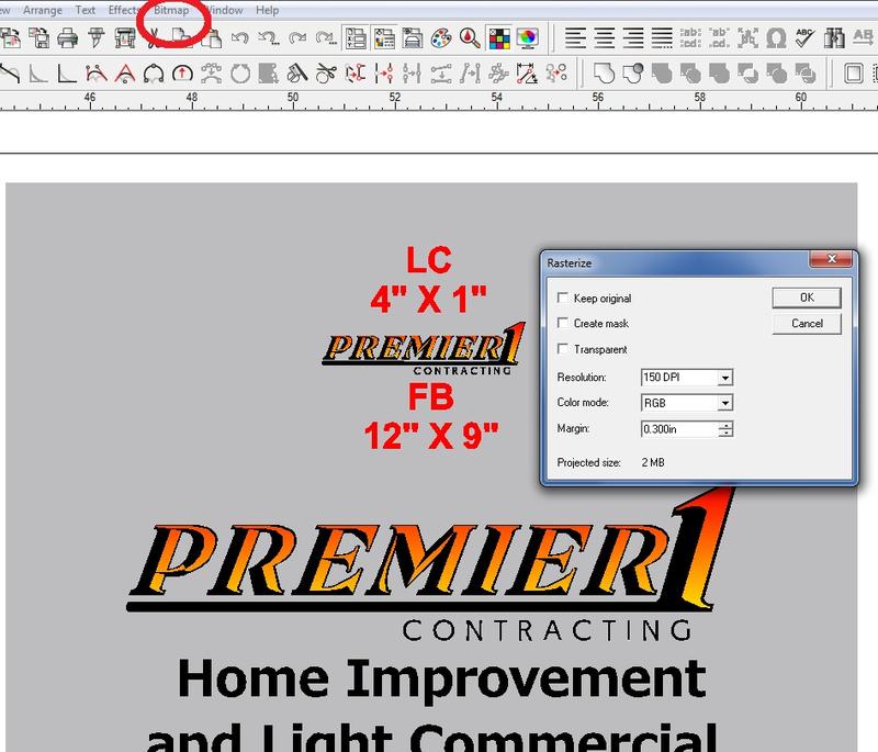

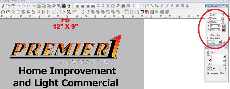

It's tricky but you can still make a mask over the raster file to make the colors correct.
I'm on Flexi 10.5 and what I do once the file is ready for export is:
create an outline/contour around the graphic
separate the outline/contour from the graphic
flatten/rasterize the art to be printed, not the outline you just created
take the outline/contour and the flattened graphic then apply a "mask"
Now you have a graphic that will not color shift (as much) that can be contour cut.
