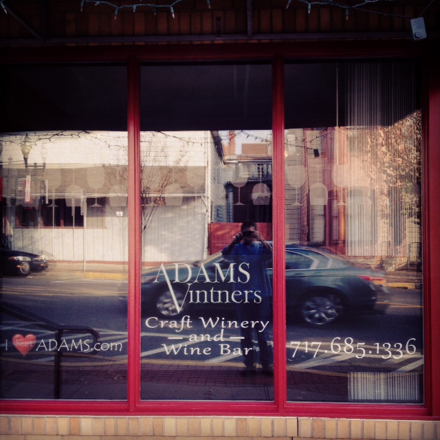

RyanFelty
Cant you reverse cut it and apply it on the inside? I just did an install recently in around 40 degree weather. Reverse cut and applied on the inside of the store and it looked great. Just a thought....

Yeah, etched vinyls are meant to be applied to second surface, unless the window is tinted I would install inside.
