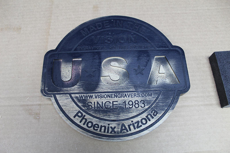

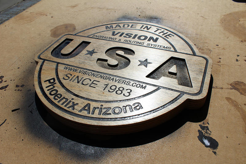

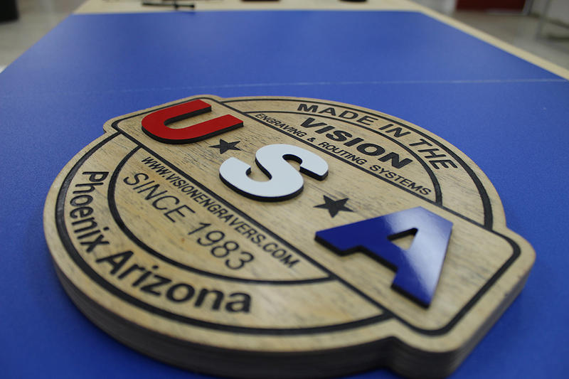

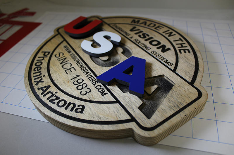

Here is a wood Made In USA Sign with PVC letter inlays.

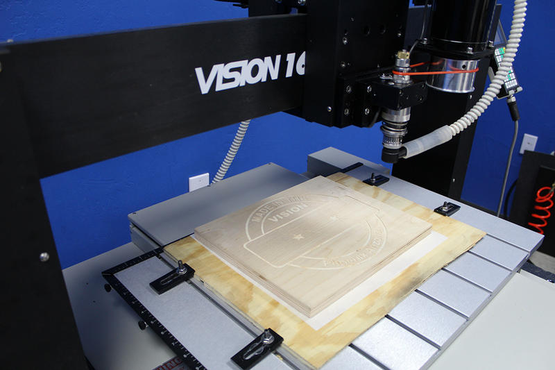

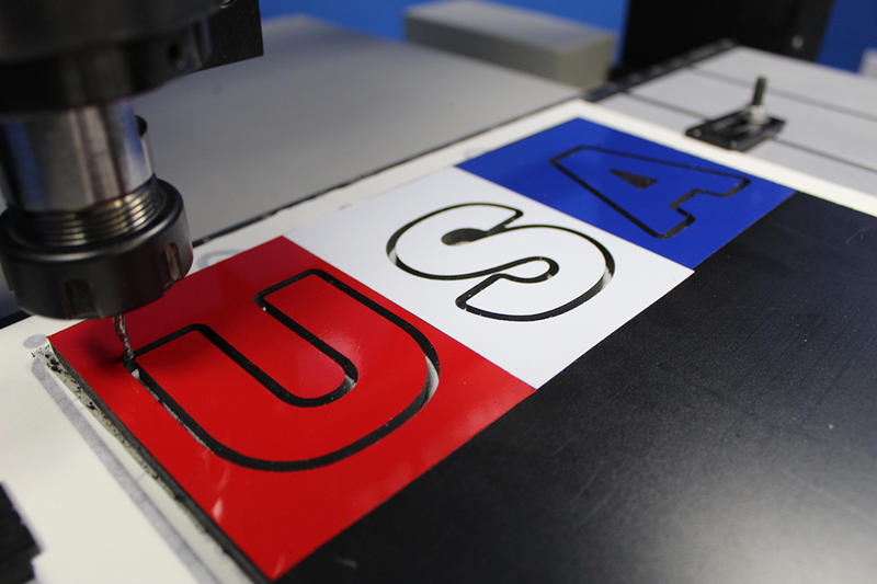

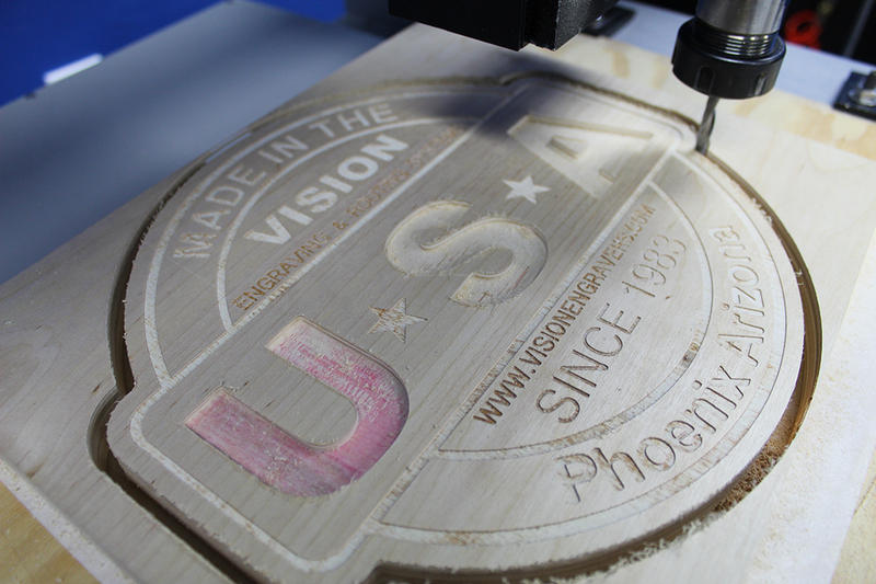

I routed the wood an PVC letters with Vision Engraving & CNC Routing Systems 1624R CNC Router.
Painted black than sanded and stained the wood.
The PVC letters I used vinyl for the color on the letters.
The vinyl was applied prior to routing out the letters.
