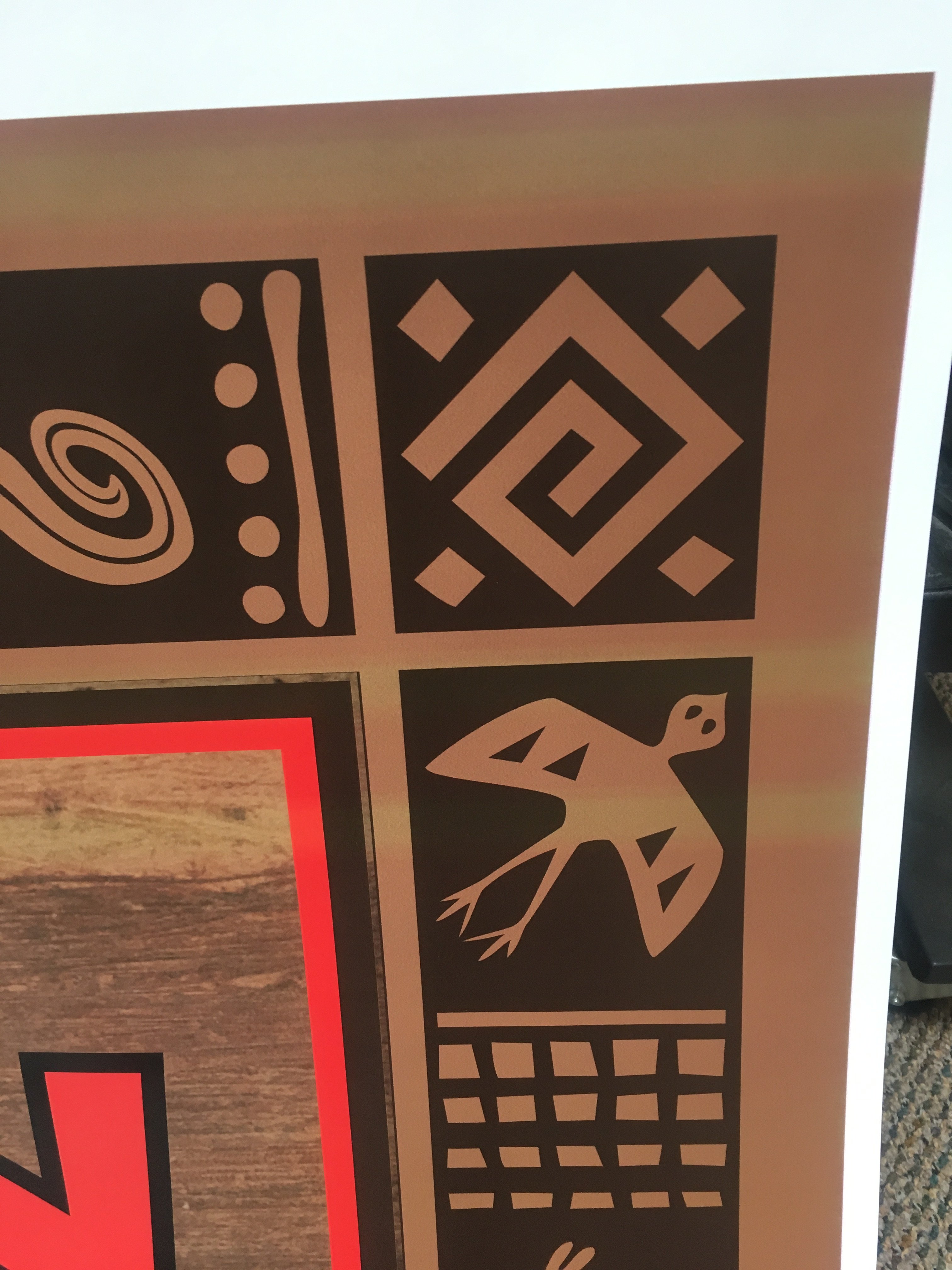

I'm working on an HP 370 and we've started loosing magenta for an inch or so periodically throughout a print. I've attached an image. Seems every 2-4 feet it will do this. The printer also will ward of a print head that may affect image quality (won't say which one) and suggests a print head test print. When we do that all appears to be fine.
Any ideas as to what could be causing this?

Need to replace one of your M/Y print heads or maybe both.

Remember that HP latex print heads are consumable. The average HP latex print head life is about 3-4 liters. How much ink have you put through the heads?

Not sure how much has gone through. I took them out too see if there was any noticeable damage and now the machine wont accept them. It just continually says to reseat the heads. Now I have two new ones on the way. What a pain.

Good practice for these printers is to keep at least 2 of each head on hand at all times. I've had multiple heads go down at one time before.
