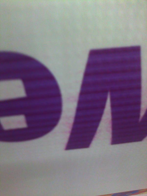

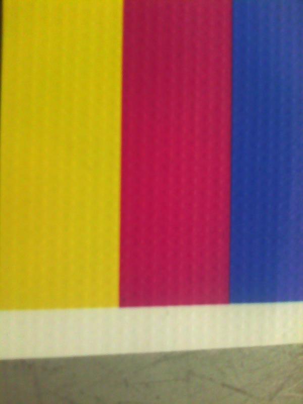

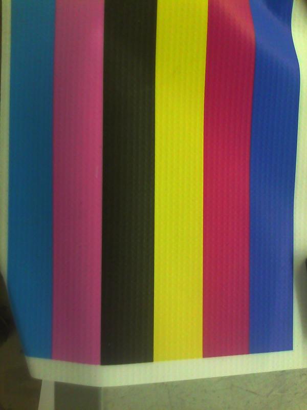

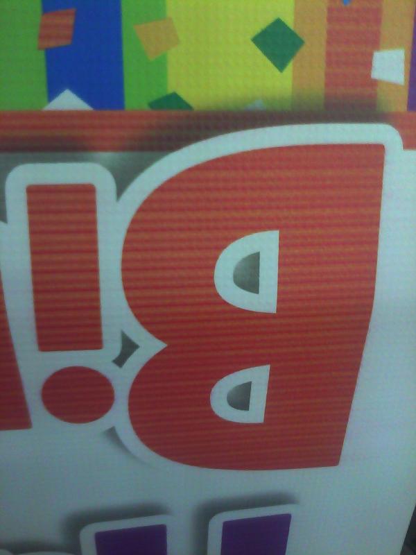

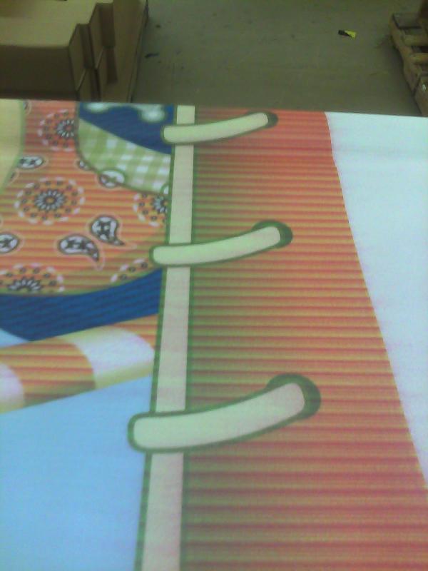

I have a xj-540 that has major magenta banding issues no matter what I seem to do. The test print and fill test both look great but as soon as I send a job with magenta in it to the printer there is major banding and over-spray. I have done the bias/vertical, horizontal and bi-dir. default and they all look good. The jobs print fine on other printers so I don't think its a job issue. I have included pictures of the banding, the over-spray and the fill test. Any suggestions? Thanks in advance.

In the last pic, the magenta and cyan overlap some... something is off.
Overspray looks like static issue.

Sorry it took so long to respond, I got swamped. It is a print head issue. We took the print head off and flushed it with ink cleaner and it is running good... for now. Usually when we've had bad print heads the test print(s) have issues as well but not this time which is why I wasn't sure it was the print head. I've noticed that we seem to go through magenta heads faster than any other. I'm curious is that an Inktec ink trait or have others who use different ink noticed this as well? Thanks for all the replies guys.
