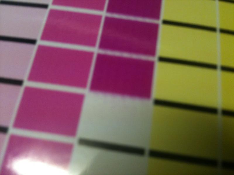

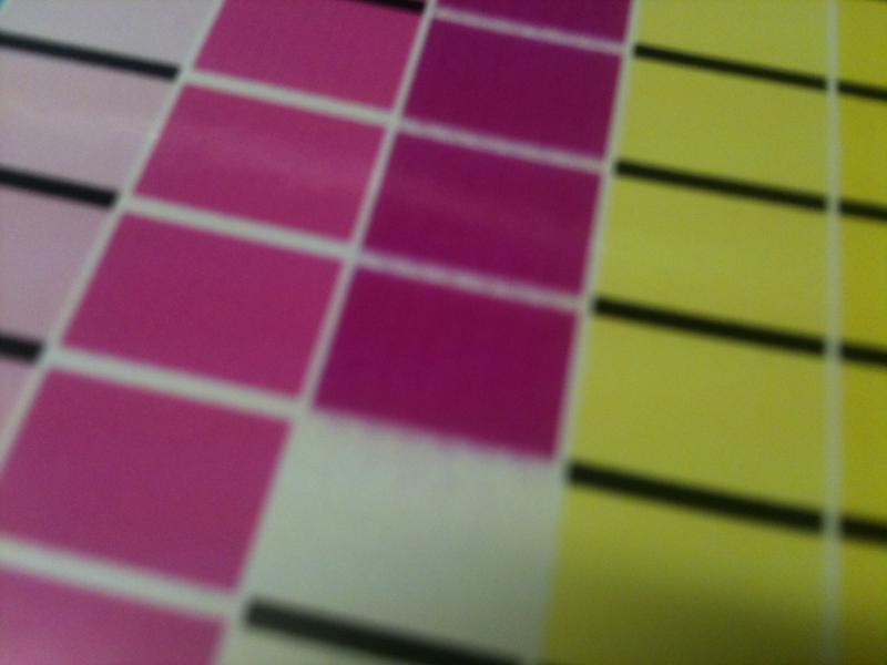

Does anyone know of any reason why the magenta head would spray when doing test prints, I've printed these bi and uni directional, the uni directional is far better, but still has slight spraying. When I print the test for bi direction prints, all the fine lines are perfect for the other 5 colours, but with the magenta they are quite blurry.
This is strange as when I do a printhead test... everything is total perfect.
Also I done a head soak by filling up the capping stations with cleaning fluid & letting the heads soak over night (this problem was still the same before hand) when I filled all the capping stations up, they all kept full except the magenta as if it was drawing the fluid down. Does this mean a leak at some point.
I've attached a 2 images of a test print, this has been taken from an Iphone so not very clear, I will take better pics later tonight.

Unfortunal I'm no tech. So don't know how a broken pump tube looks like. But as I see, you've printed a linearisation chart. May be, the magenta channel lays down much to much ink? May be, this over-saturation of magenta results in this bleeding effect. As your pics are not very crisp, it's difficult to make a diagnosis. Just an idea, as you said, that the test print is perfect. What does happen, if you print a 100 % magenta square with a correct media set? Does it look like the lin chart?

That was the before image, it's not over saturating the media as when I do a standard tests via the printer it's self (not including the print head test) the printed lines for magenta comes out very fizzy/blurry but all the other channels are perfect, but when I do a standard print head test all the lines are lay down perfect for magento, I've got the after image here where I've adjusted the Linearization it does make a difference but still not perfect, I think it has to do with the cap head leaking or drawing in air as the prints start perfect... but then become blurry by the end of the image or text when printed.
