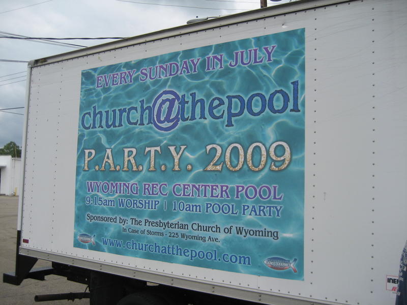

You must be doing something wrong or else you have a major humidity problem. We run rolls and rolls of phototex here w/o issues. We had a roll separate from the backing/ripple for the first few feet after being stuck in a corner for a year once, but it was near where there was a leak under a wall when it rained really heavy so I think the backer picked up a bit of moisture.
I once made a phototex "wrap" for a box truck's sides that sat in a parking lot for a month every summer, and then we removed it and put it back on the backer until the next year. We re-used that same wrap for three years w/o any issues until they discontinued the event. (we just put a patch over the year part the following years)

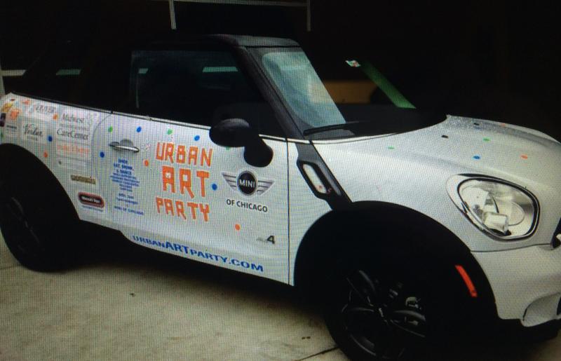

i use phototex for parade "magnets". never an issue, and clients LOVE how little effort it is to install/remove them after a day or so of advertisement. ...and they can be rolled-up on themselves and stored for re-use, if desired.
I just inform the client that they will hold water/moisture on the side of the vehicle like a damp cloth, if it gets wet.
Which is only an issue in some scenarios.
noted: pain in the butt to print&cut, as it is a fabric-like material, but I just double-cut the same path. pic shown of a donated "package" of phototex logos I mailed to a friend in Chicago for a charity event at a Mini dealership. I think they sat outside for a week, mostly in the rain, before finally being removed.
